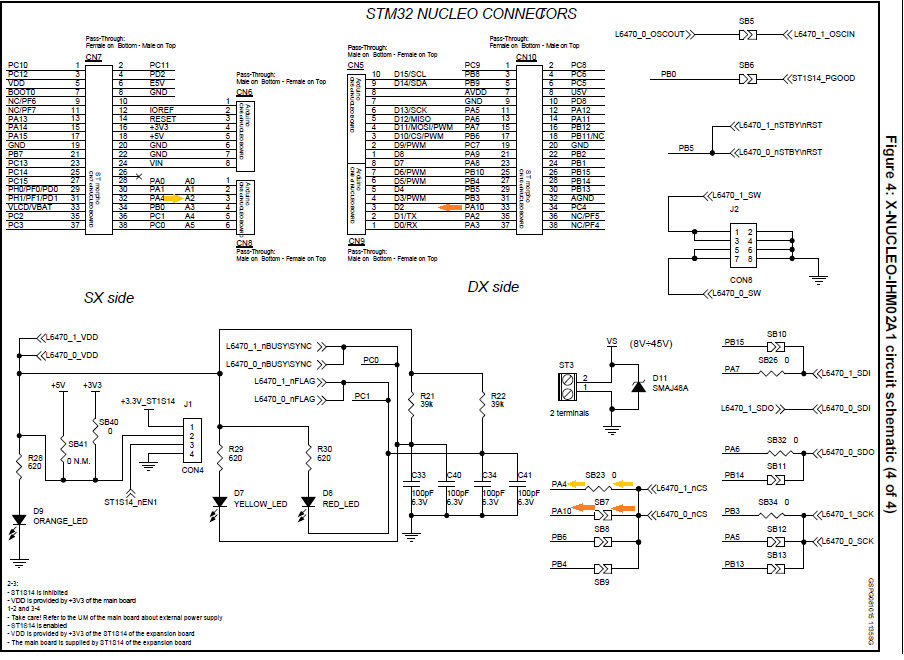

I'm using an STM32F767 MCU along with two shields: IHM02A1 dual stepper motor driver.
Here are steps I did for the IHM02A1s:
1. On both shields, unsolder SB34 and solder SB12.
2. Change this in main.cpp:​
dev_spi = new SPIClass(D11, D12, D13);
3. On the second (top) shield, unsolder SB23 and solder SB7. "So, when using more than one expansion board, the user must short a different solder bridge among SB7, SB8, SB9 and SB23, for each X-NUCLEO-IHM02A1."​
st.com/content/ccc/resource/technical/document/user_manual/group0/9c/49/e6/da/a3/75/48/b9/DM00237629/files/DM00237629.pdf/jcr:content/translations/en.DM00237629.pdf#page=11
4. Change:​
x_nucleo_ihm02a1 = new XNucleoIHM02A1(&init[2], &init[3], A4, A5, D4, D2, &dev_spi);
https://www.mouser.com/ds/2/389/x-nucleo-ihm02a1-954332.pdf#page=5
Mbed's online IDE does not have a debugger. I do not have one right now, but I will eventually...Keil uVision's 32 kB max project limit was :/
In short, the bottom shield works (moves motors). The top shield does not actually cause the motors to move.

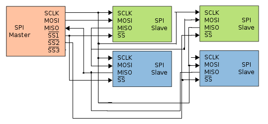

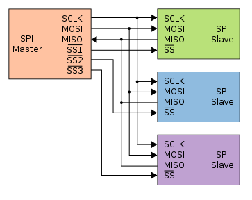

Adam Uraynar
Joined Dec 21, 2015
67
i'm not SPI (aware) , but
- ? if so how you set their addresses (i'm also poor reading the type of diagrams ? the SB23 0 ?)
  • DO (data out), SDO (serial data out), MOSI (master out, slave in) all mean the same thing
  • DI (data in), SDI (serial data in), MISO (Master In, slave out) all mean the same
  • /CS (chip select), /SS (slave select), nCS, nSS all mean the same thing
    • Both ‘n’ and ‘/’ mean the signal is active low, not active high
The basic concept of SPI is that the master initiates every communication. Also one bit is sent by both the master and the slave on every clock edge.
Say you want to read two pieces of data from the slave, you can chain commands together.
MOSI [Read command 1] [Read command 2] [don’t care]
MISO [don’t care] [Response 1] [Response 2]
Note the slave can’t respond until it’s received all of command 1. In this example, command 2 provides the clock edges for the slave to respond with.
At the end, the master must clock an additional packet in (the don’t care above) to get the final response out.
Moving up the chain in complexity is independent slaves:
The clock, MOSI and MISO lines are shared. Each slave has a chip select (/SS) and responds when addressed.
Moving up the chain again is daisychained slaves.
If I want to talk to green, I feed one packet in to write the command. Green sends its response to blue, and blue sends its response to purple, and purple to master.
If you want, you can command all three at once, but you’ll need to send a bunch of don’t care data to flush the shift register and make sure Blue doesn’t try and use green’s response as a command.

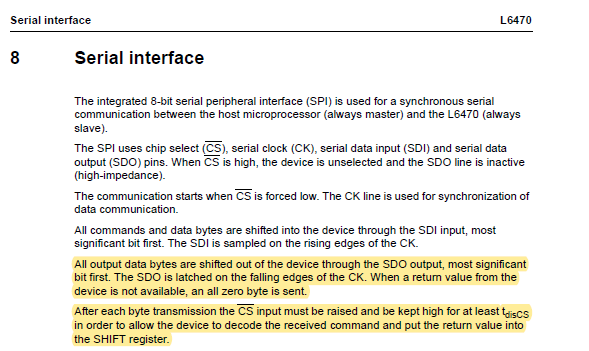

Looking at the Nucleo schematic, you’ll notice L6470_1_SDO (Serial Data Out) is connected to L6470_0_SDI (Serial Data In). This is a daisy chain configuration. Also note how the bridging SB7 leads to the D2 pin on the board.
Looking at the part datasheet, it will start reading data when /CS is low, and will keep shifting data out until /CS is high.
By stacking a second board, this configuration results—it’s a combination of both the daisy chain and individually addressed version above:
Motor 1 and 2 move, so nCS1 is working.
Probing nSS2dd with the scope—should jump between 5v to 0v—which it does (~4 V)...
All four nCS's are connected in the middle (as shown on the right in red).

You have two shields.. Each with a dual motor connection.
so there has to be two inits with the CS for each
so.
DevSPI dev_spi(D11, D12, D13); is for the one on pin 13
DevSPI dev_spi(D11, D12, D3); is for the one on pin 3
Then..
L6470_init_t init[L6470DAISYCHAINSIZE] = { …. }; needs to be initialised on CS 13 AND!! another has to be initialised on CD 3..
When you use them read the docs that come with the SPI as I think you can send DevSPI dev_spi() with only two parameters..
Then you can control the two CS pins independently..
BUT!!! I don't know enough about this "Daisychainedsize" business! If both shields are on the same CS pin then you'll need to show the datasheet for that shield as you may need 4 motor inits and not two...

Since I don't have a debugger yet, I un/commented a bunch of stuff out to "debug".
The issue is or at least starts here:
Code:
    x_nucleo_ihm02a1 =    new XNucleoIHM02A1(&init[0], &init[1], A4, A5, D4, D2, &dev_spi);
    x_nucleo_ihm02a1two = new XNucleoIHM02A1(&init[0], &init[1], A4, A5, D4, A2, &dev_spi);
Otherwise, the second pointer and such work on it's own. When I uncomment either of the lines above, no motors move (while still compiling).

1,136
Look at post #8 It shows 1 SPI initialisation and 3 motor initialisations on the same bus.
If you are not daisychaining them the you will need to init 2 motors on the first shield and init 1 motor on the second shield..
Effectively..
init SPI
select cs1
init 2 motors
unselect cs1
select cs2
init 1 motor
unselect cs2
then....
move motor 1 or two with cs1 and move motor 3 with cs2
All I see from the first bit of code is 2 motors initialised on one shield.. I cannot replicate any of this as I haven't the hardware..
