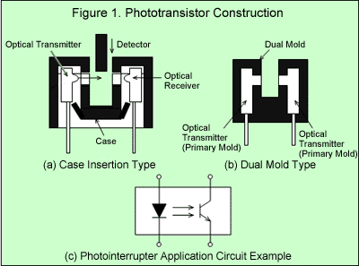

Use an indexing device, though this is likely to work poorly, but you can use the same motor and the same driver you have now. With this method you attach a disk to the motor's shaft and make hole in it, and then use an optical detector to tell when the disk is in the position in which light passes through the hole. To make the motor run slowly enough to stop right after the hole is in front of the sensor, job the motor will narrow pulses at a low frequency. A lot of experimentation will be required.
