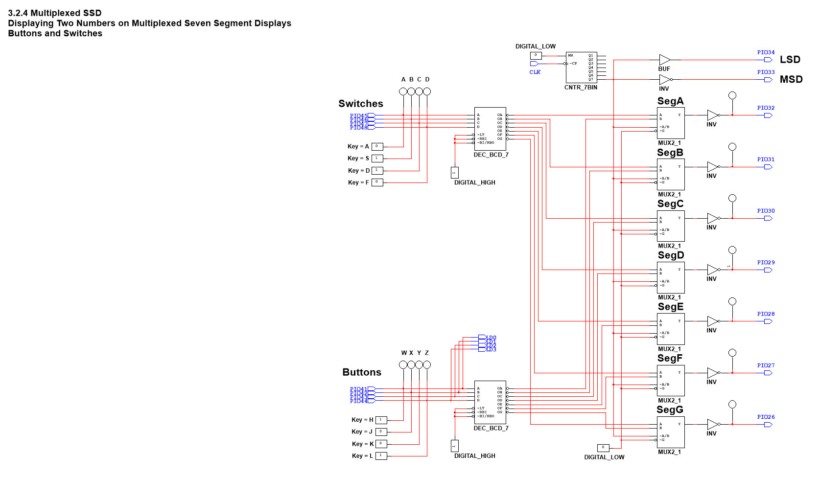

Hi. Please help me!! I have a project with my partner. It has taken my class two weeks so far, but my partner and I are definitely behind every other group. Our project is simulating a deli number counter. This is the circuit that we are building off of. Where it says switches, rather than those pins on the end, we need to create an SSI D flip flop asynchronous counter that goes from 0 to 8. Where it says buttons, we need to do the same but have an MSI D flip flop asynchronous counter that goes from 0 to 9. Essentially both of them together go to 80 maximum and everything beyond that resets to 0. We are also required to have a clear set for both where anytime you clear it, it sets the whole thing back to 00. I am so confused and our teacher does not like being asked for help. Someone please help me. My partner and I are falling behind and we are obviously not the greatest students in the class. We have no idea what to do. Thank you.

Ok I made the d flip flop ssi. It supposed to go to 8 but I got it to 7. I not know how I would do 8.

Have you figured out how to count to 8 yet? You said you can count to 7; how many flip flops are needed to count to 7? How many bits are needed? If you need a larger number or 7+1 in this problem, how many bits will you need?

Mine is 4 bit, but the last flip flop I didn't make it effective because then it goes to like 14 or 15. So I don't know how to to get it in the middle and go to 8

The secret search phrase that is about to be revealed to you should teach you how to solve your problem. Read some of the articles and then come back with an update for us.
module n counter

Or perhaps try "modulo n counter" instead.
Can you take your four-bit counter and modify it so that you have an additional input that resets the counter back to 0?
Can you take your four-bit counter and add a bit of additional circuitry that produces a HI when the counter's value is 8? (or make it 9 for right now).
