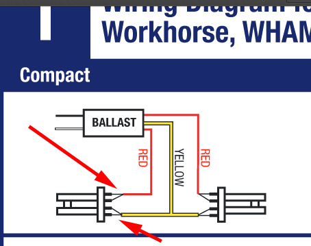

hello all.
i need to make my own UV light box. the bulb i have is Philips PL-S style, a 2pin 60vac 0.17amp bulb (basically a low pressure)
i was trying to hunt down a electronic ballast but cant seem to find one, the ballast folks keep telling me that only a coil ballast can be used. okay, i went onto a big name website and looked at their WH2 elect ballast wiring diagram, and it shows the ballast connected to a 4pin bulb, BUT, they parallel the pins, so isnt that a 2pin at that point (see below pic, me added the arrows) ?? i either don't understand electronic ballast or the company doesn't understand the pin connections in their diagram.
a coil ballast needs to be around 350ohms @60Hz120vac to kill off some voltage for the PL-S bulb. The PL-S bulb has self-ignition, so is there any reason i cant use a 350ohm 10watt (on heatsink with fan) instead of a hunky coil?
