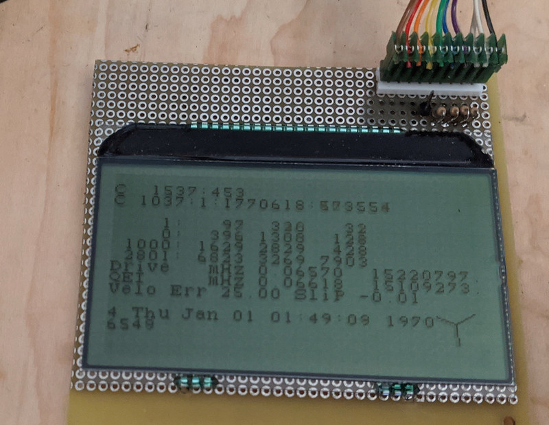

Added a new display type: DOGXL240-7 https://www.lcd-module.com/fileadmin/eng/pdf/grafik/dogxl240-7e.pdf
A lot more real-estate. I built another display board with the back-light and led current driver but you don't need it in normal light conditions.
Same 8MHz SPI interface and basic driver guts.
Low speed motor application display on the PIC32MKMC board running the Teknic AC servo IPMSM motor with 3 phase 0.066 millihertz (0.001 hertz) sinewave drive signals using encoder feedback for speed (QEI clock timer counts between edges) control and positioning.

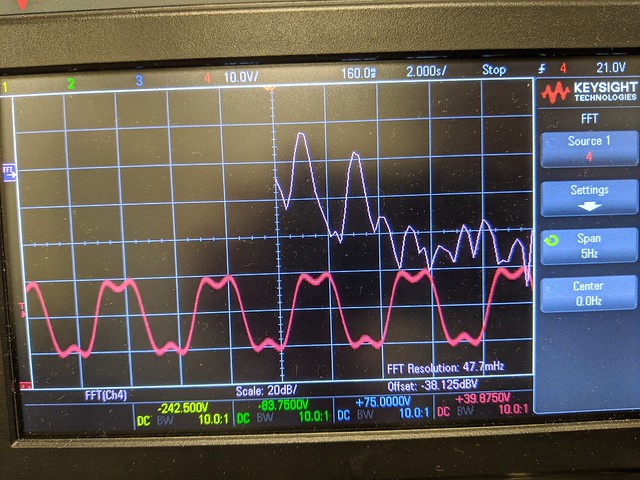

SAPWM (Saddle PWM) waveform theory and application.
https://www.infineon.com/dgdl/AP160...M.pdf?fileId=db3a304412b407950112b40a1bf20453
https://ieeexplore.ieee.org/document/5712490
Improved inverter utilisation using third harmonic injection
C. Generation of Switching Signals
The general block diagram for generation of the switching pulses is shown in the fig. 6(a). The reference voltage Vref is added with signal having frequency three times of fundamental frequency and the magnitude is 1/6th of the fundamental amplitude. The resultant is then passed through comparator which compares the modified signal with the carrier signal of frequency 2 KHz. In the fig. 6(b) the combination of all the three signal is been shown.
Here I just generate a static sin table of the needed waveform when the program starts that's used later in the software for the PWM modulation index.
\( y=\sin \theta+{1\over 6}\sin\, 3\theta \)

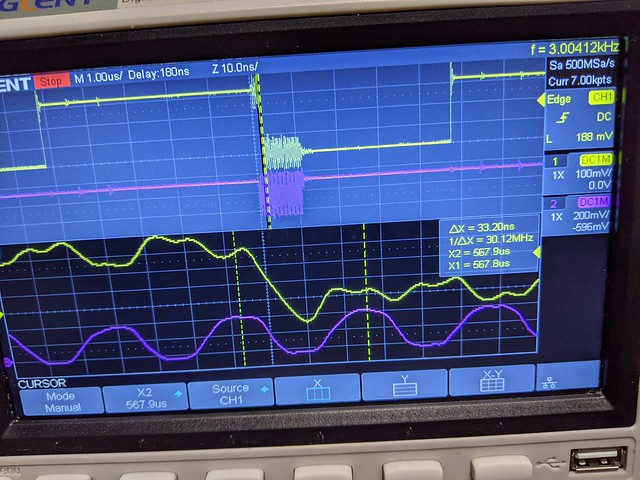

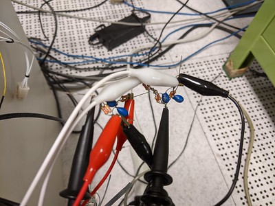

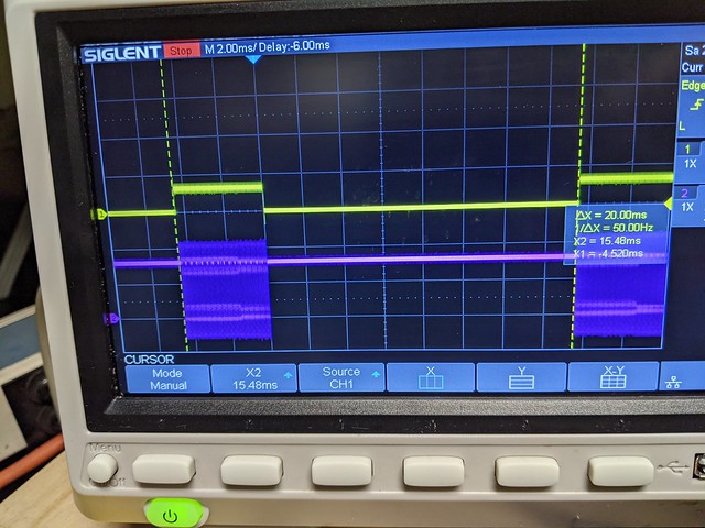

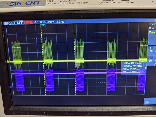

O-scope RC filters for PWM motor drive signal.
FFT of fundamental and third harmonic content.
PWM phase signal (filtered to remove the pwm carrier) waveform. One of three phase shifted generated from the sine_const table.
Two pwm phase shifted signal waveforms (top/bottom) and the center MATH line waveform (clean sine-wave) that drives a set of motor windings on the 3-ph motor.

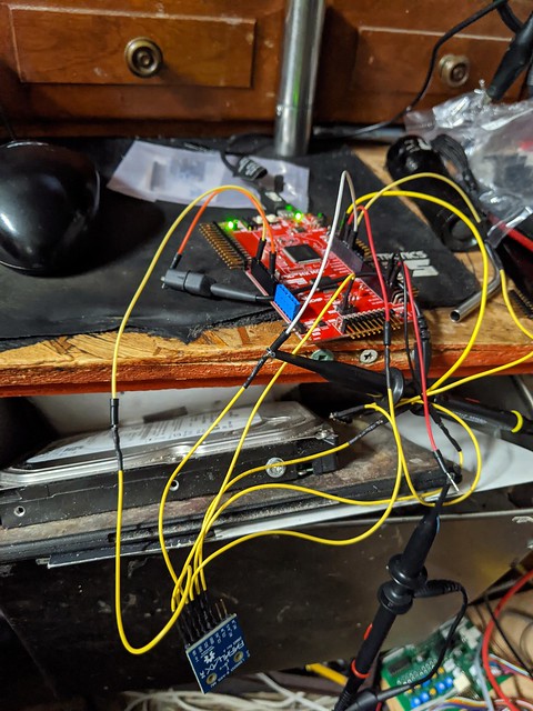

Nice board but something is wrong.

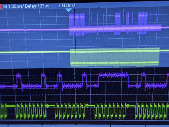

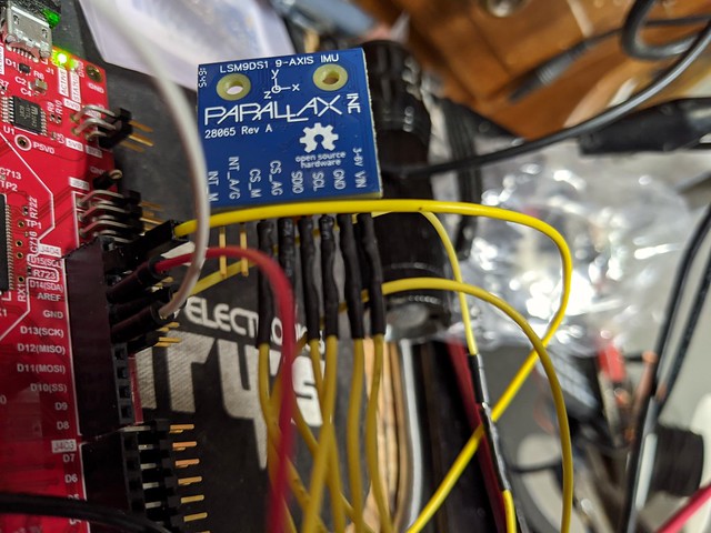

I'm testing some SPI interface code to a Parallax LSM9DS1 9-axis IMU Module using the PIC32MK MCJ Curiosity Pro Development board (DT100113) with the PIC32MK0512MCJ064. So far the hardware is solid but some numb-skull put the Arduino Uno digital header pins backwards on the DT100113 PCB. The labels are right but none of the electrical pins go to the correct place.
LOL The PCB header pins should start from the bottom and work up per the label and standard shield connections.
As you can see the IMU module uses 3-pin SDI half-duplex so the MISO and MOSI are shorted together at the controller board with a single data wire to the module.
The setup for 3-wire SPI on the PIC32MK is simple. You can change the SPI TX pin function when needed to a input PORT pin function.

Inside the read function we switch TX pin modes from TX (send address to read) DISSDO=0 to receive with DISSDO=1 so the data sent by the module doesn't get clobbered by the uC bits on the single wire when we read back data.
The data at SPI 8MHz clocks during bytes 6 & 8 are responses from the module for the init device queries.

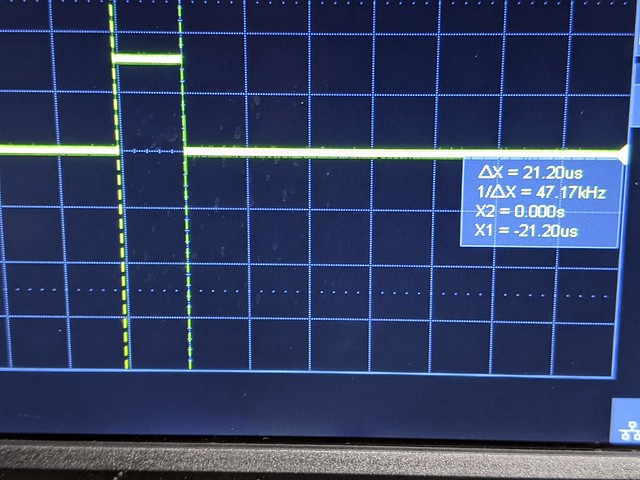

Once these are read and checked the rest of the init sequence of spi data exchanges can continue.

Made a sensor 'Hat' for the dev board. The stupid design error on the Microchip PCB required the removal of the ground connection on one pin of a standard shield proto board but the rest were OK being connected flipped around on the digital side.
16,494

It's a DOGS102-6 LCD (102x64 PIXELS) that uses the UC1701x 65x132 STN LCD Controller-Driver.
https://www.lcd-module.de/eng/pdf/zubehoer/uc1701.pdf
The other graphics display is a DOGXL240-7 with a UC1611S 160COM x 256SEG Matrix LCD Controller-Driver w/ 16-shade per pixel but that's on the back burner.

void OledClearBuffer(void)
    uint8_t * pb;
    DEBUGB0_Set(); // set timing flag bit for o-scope
    if (disp_frame) {
        pb = rgbOledBmp0;
    } else {
        pb = rgbOledBmp1;
#define USE_DMAok
#ifdef USE_DMAok
    while (DMAC_ChannelIsBusy(DMAC_CHANNEL_1)); // wait for possible DMA1 transfer to complete
    DMAC_ChannelCallbackRegister(DMAC_CHANNEL_1, CBDmaChannelHandler, 0); // end of transfer interrupt function
    /* setup the source and destination parms */
    DMAC_ChannelTransfer(DMAC_CHANNEL_1, (const void *) rgbOledBmp_blank, (size_t) 4, (const void*) pb, (size_t) cbOledDispMax, (size_t) cbOledDispMax);
    DCH1ECONSET = 0x00000080; // set CFORCE to 1 to start the transfer
#else
    int32_t ib;
    /* Fill the memory buffer with 0.
    for (ib = 0; ib < cbOledDispMax; ib++) {
        *pb++ = 0x00;
    DEBUGB0_Clear();
#endif
Software:
Mainline code is stuck burning cpu time for this amount of time while the routine completes.
DMA hardware:
The total time to complete is much quicker and mainline code only does the setup and trigger, it doesn't wait for completion.
https://ww1.microchip.com/downloads/en/DeviceDoc/60001117H.pdf

The top Yellow trace is time in the mainline execution thread during the screen update. HIGH means CPU working on SPI transfer.
The Purple trace is 8MHz SPI clocks.
Pure CPU is fast but it blocks (yellow trace is HIGH) user code execution until it completes and there are sometimes gaps when sending single byte commands/data.
Interrupt driven SPI could be used but it's usually slower and still has CPU usage during actual I/O transfers.
With USE_DMA and DMA_STATE_M defined all I/O is handled by the DMA controller and page/addressing commands are handled in the DMA event ISR state machine.

The top yellow trace is time in the mainline execution thread during the screen update. HIGH means CPU working on SPI transfer.
Now the only time the CPU executes for SPI transfers is the short time it spends in the event interrupt code setting up the GLCD page/address DMA transfer and then the DMA transfer setup of the actual page data. That's only several microseconds of time away from mainline code thread execution per every SPI block transfer.
>60Hz possible refresh rate with minimal CPU and Interrupt usage during the SPI transfers.
I've always thought that a scope's graph is a thing of beauty... especially when everything works according to one's desire... :)
