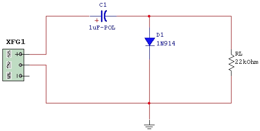

Hello! Why the output waveform is different when 22k Ohm RL is change to smaller value? What is the significance of this change in output waveform?
Thank you! I use square wave input with 1000Hz and 10V peak-to-peak.Welcome to AAC!
What is the frequency, amplitude, and type of waveform for the input.
Yeah thank you!Does t=RC help?
