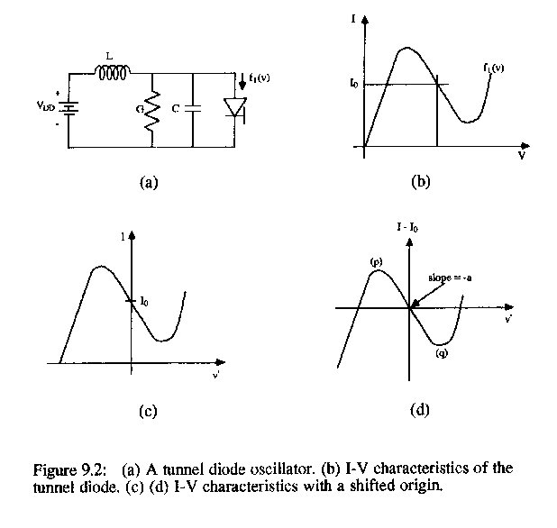

The problem is that the output voltage is logarithmic to the irradiance. So there'd be alot (enough?) current through it when the sun shines, but next to none (relatively speaking) in the morning.
Hm, is there a non-linear device that draws more current (lower resistance) when there's less voltage...?

Interesting - thanks spook! :)
