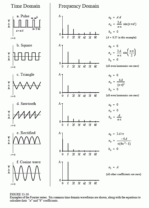

Hello,
I want to reproduce a paper I read about magentic tracking. I have trouble undertanding how the oscillating magentic field is produced. On page 3 of the paper they outline how their circuit looks like.
It has a signal generator (AD9833) that generates a 100KHz signal. That in turn feeds into an active band pass filter (AD8616) which then goes into a multiplexer and is switched between 3 coils.
I ask myself wether or not the signal ever is negative ? Or is it just a pulsed DC signal. But if that's the case, what does the bandpass filter do ? And if it's pulsed DC, is it generating an oscillating magnetic field ?
So I guess my question is: Is thesignal that goes into each coil a pulsed DC signal or an AC signal ?
thanks,
8dm7bz
