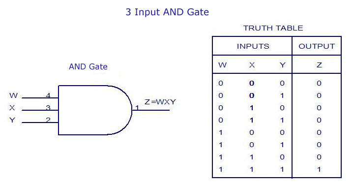

You can make a slowly fading in/out DIGITAL signals with TWO 555 timers and a comparator or an op amp wired as a comparator.
Set up one 555 to pulse at about the frequency you want for a fade in or phase out.
Set up another at 100 to 400 Hz range.
Take the "triangle" wave output of each 555 timer (pin 6 if I remember correctly) to an input on the comparator.
The output of the comparator will now be pulse width modulated (pulsing at the speed of the faster 555 timer but the duty cycle of the pulses will depend on the current position of the slower 555 timers triangle.
Now, since your "fading" is really done with controlling the pulse with of on/off cycles, you can use a simple aND logic gate to combine all three requirements.
Connect the comparitor to W, your A Output to the X input and your B output to the Z input.
Then you can connect the AND gate's output to a resistor and that resistor to a transistor used as a switch, the LED to the transistor (post again if you need clarity on this section, let us know).
Note: the AND gate cannot be used if you want an analog dimming/fading of the LED. Only works with the Pulse modulated option.
Note 2: you can also use a quad 2-input AND gate and make two stages of AND with three of the 4 AND gate on the chip.
Note 3: I don't know how strict the 3.3 volt requirement was but you can find 3.3v AND gates if needed or find use some 2N7000 to shift level - ask if you need help
The output will only turn on when all three
