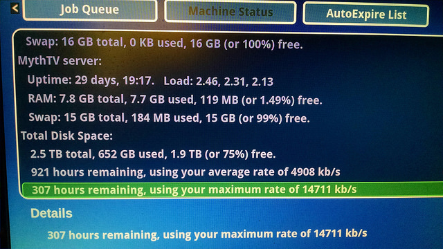

The local OTA broadcaster inserts EPG data in the transmitted broadcast data-stream. They can transmit up to a 16-day Program Schedule but most are shorter. When not recording MythTV scans all known HDTV channels in it's database for EPG data, it then formats that data for scheduling use.

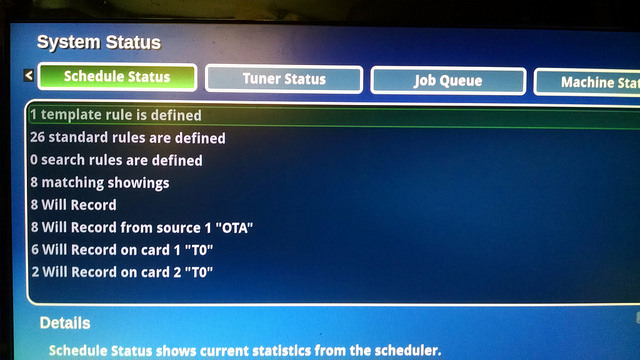

Some stations here have a few hours but others like PBS have 7 days. I've seldom had a problem with two tuners usually because at least one is always scanning for EPG to match upcoming rules for recordings. While you can't see the OTA EPG data very far ahead on some channels it still updates in time to make the recordings work if the recording rule is already in place.

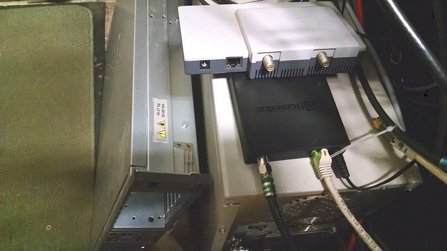

My original HDHR box died after about 10 years so I using a connect duo now. A tiny black box with no front panel blinking lights but it works just fine with Linux Mythtv.
