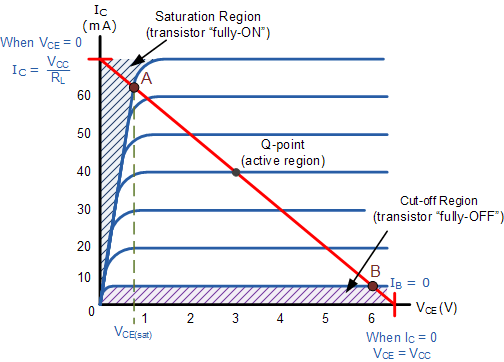

2) The bias voltage of a transistorized circuit is determined by the components in the circuit and not by a specific "bias voltage" of the device. One way to determine the proper bias voltage is to superimpose a "load line" on top of the I-V characteristic curves of the device.
From this one is able to establish a DC operating point (Q-point) and to analyze the AC performance of the circuit.
Yes, I understand that it is determined by the components, not the transistor. Every device has a certain range that is required though, correct? And I am saying I replace it with another with the same range.

There is no "bias voltage" in the datasheet because a BJT can have any bias voltage that a designer wants to have. for a Class A amplifier it might be in the middle of the load line, but for a Class C amplifier it might be close to cutoff, so only the peaks would cause conduction.
