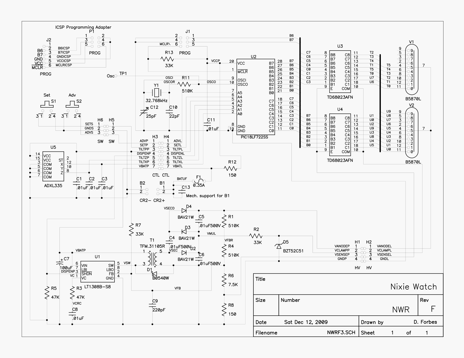

Just bought 4 NL-5870s and they are a little to small for an aesthetically pleasing clock, so I'm planning on doing a watch.
No where have I been able to locate any open-source nixie based watches. The closest I've come across is CathodeCorner's watch, which is like the originator of the nixie watch, were they show a schematic of their watch but it's in pdf form. I've used CAD software like, Eagle, but never on something this complex and since it's a pdf, and not a Eagle .sch file, it's not really usable ATM.
Does anybody have a board that they've made for nixie watches? I'd be willing to compensate for a board or board files. I guess I could hire someone to turn that schematic into a proper format for production, but I would imagine it would be quite costly so I thought I'd check here first.

No market projections, I'm not interested in selling anything, plus the design isn't licensed for commercial reproduction. By production I just meant files that can be readily sent off for fab to one of the small batch PCB fab services, like OSHPark or DirtyPCBs.
Schematic can be found here
http://www.cathodecorner.com/nixiewatch/firmware/nwrf-schem.gif
Overall I think this is a well done circuit but I would change a few things, make it more simple and fit into a smaller case.

John:
I will definitely be interested in taking you up on that offer. I want to remove the adxl335 accelerometer that this code uses to activate the display in order to safe the battery life. I plan on adding a touch sensor/switch to trigger the display, to me it's much more simple and less prone to accidental activation.
Plus I am thinking about doing away with the CR2 battery in favor of either a coin cell or a lithium polymer battery with a micro USB recharging feature. I'm just concerned with the reliability and safety of the LiPo batteries.
I started trying to cobble together a board layout based off of the schematic above. I was using EagleCAD but none of the ICs are included in the "Components" library, so I've been trying out Upverter's layout program. The cool thing about Upverter is that if a component you want to use isn't among the pre-loaded parts, you send a copy of the datasheet to the "Concierge" and they will create the part symbol for you! My progress is quite slow going.
This might sound like a dumb question but when you read s circuit schematic, is there any way to tell what size/packaging of each component? Or is it up to the individual to decide?
