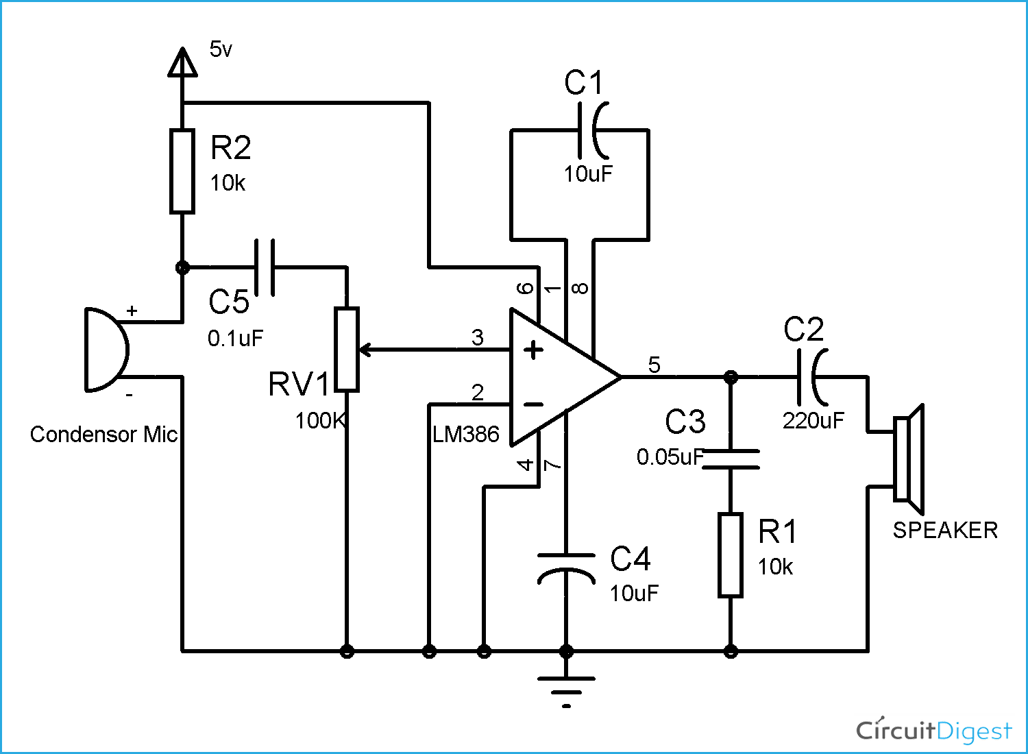

Here is a relatively simple and popular audio amplifier circuit:
There are five capacitors in this diagram, C1 to C5.
Each one has a specified value. Did the circuit designer pull the numbers out of a magic hat?
Absolutely not. Each capacitor has a function and the desired value can be calculated based on the criteria of its function.
Volttrekkie
Joined Jul 27, 2017
63
Based on the criteria of its function? Now I am really confused. What criteria? This is where precisely I get lost. HELP PLEASE!!!

Oh, OK. So, it depends on experience. There is no formula like V = IR or Q = CV that can be applied to get the correct size.
Yes, there is.
BUT there is no *one* equation for all applications. The equations to calculate the capacitors in audio amplifier tone controls is very different from the one to calculate the size of the bulk filter capacitor in a linear power supply, or the output filter capacitors in a switching power supply, or the timing capacitor in a 555 oscillator, or or or ...
Sticking with capacitors, for many applications the equations have their origins in one or two basic equations. One relates how the impedance of a capacitor changes with the frequency of the signal going through it. The other relates how long it takes to charge a capacitor up to a specific voltage given the voltage source available and the type of charge current limiter. Both of these are derived from the basic equation that defines a capacitor and how it relates to voltage and current.

This is precisely where I get confused. I can see C1 through C5. Now, how are you supposed to decide the value for each?
I mean, seems to me, anybody can just read the schematic and plug in the necessary components into a breadboard without knowing why. Obviously, that does not mean you know electronics.

Perhaps you should tell us your experience level. Differential and integral calculus describe perfectly the "right" value for C5, the input coupling capacitor, but would that tell you anything useful?
Also, you are missing a critical component - the requirements for the circuit. These don't come from equations, they come from the circuit user. There is a huge pile of differences between the technical requirements of an EEG preamp and a phono preamp. Those requirements drive the overall circuit topology and the corresponding design equations. So, for example, how did the designer decide that 0.1 uF was an acceptable value for C5, the input coupling capacitor? First, by knowing how much, or how little, audio "quality" he wanted the circuit to have. There is no equation *for* that. The design equations come *from* that.
