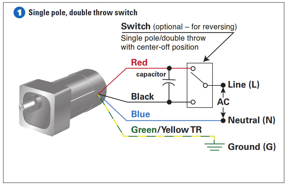

Actually a PSC with identical winding's are just as easy, if not easier, to reverse than DC.
Most of the G.D. openers in N.A. are Chamberlain or relabeled, and these predominantly use PSC motors.
