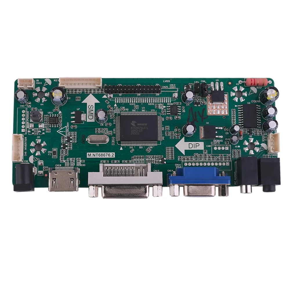

For measuring the probe goes to test poing and the grounding aligator goes to ground of the Board. I ask if i can put this aligator to one of those 4 suns.
