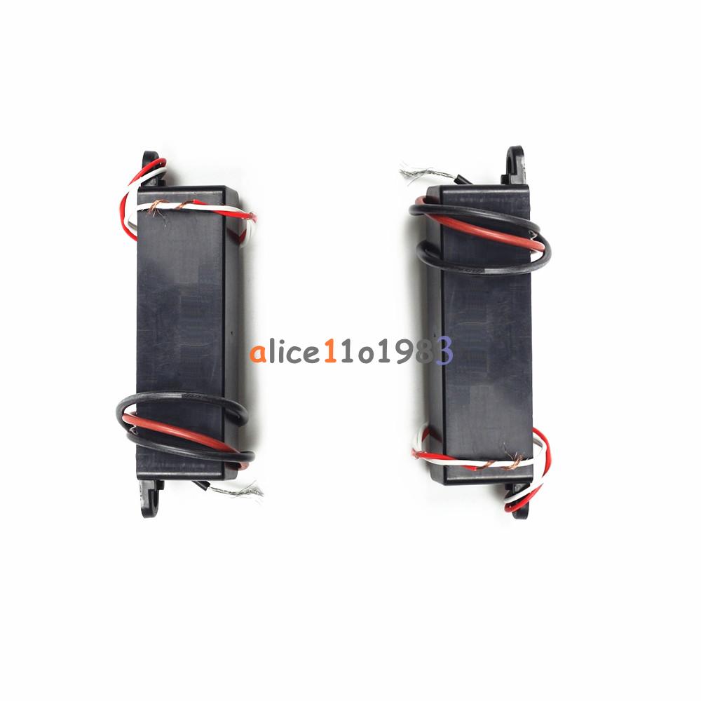

The video shows how to connect the input power and the two high voltage wires.
From your link:
Note: Small red and black line is input, red is 12V power supply positive input, black is negative input, thick red line is high voltage positive output, thick black line is high voltage negative output.
#12
Joined Nov 30, 2010
18,224
Do I see 5 wires on that voltage generator?
If you have a naked wire on the input side, it is a safety ground, which has no purpose for you.
