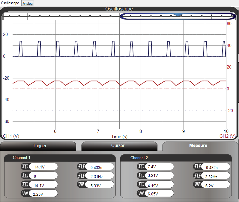

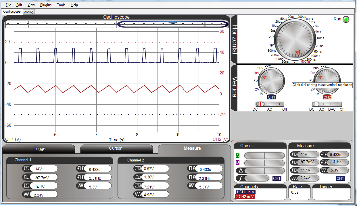

Here is the scope and the way it is laid out, although I won't be sure if I need the transistor yet until I get this oscillation straightened out.
This scope is the output of U2 vs U3
You are exactly right, part of the triangle is showing up with the upper and lower points being clipped. How do I get rid of this cross talk?
This scope is the output of U3 vs the inverting input of U3 (connected to the output of the potentiometer)
Some op amps have back-to-back diodes between the inputs for overload protection. They are normally invisible when the op amp is being used in the linear mode with negative feedback but can allow crosstalk between the inputs when one input is overdriven as compared to the other, as occurs with the 3rd amp. This could allow part of the triangle-wave to appear at the input with the pot, which is likely what you are measuring. A scope would show that, if you have access to one.

That is correct. The comparator amp is running open loop so there is more than 1V across its inputs during most of the cycle. Adding a 15k ohm resistor in series with one of the inputs (either one, you don't need both).
Note that the crosstalk has no effect on circuit operation since the voltage difference is only a few mV when the comparator changes states.

You can get by with just one resistor, if you like, but that will just reduce the cross talk not eliminate it, since there are still the diodes internally across the inputs. The resistors are mainly to protect the inputs from excess current.
As I previously noted, that crosstalk has no effect on the comparator operation.
