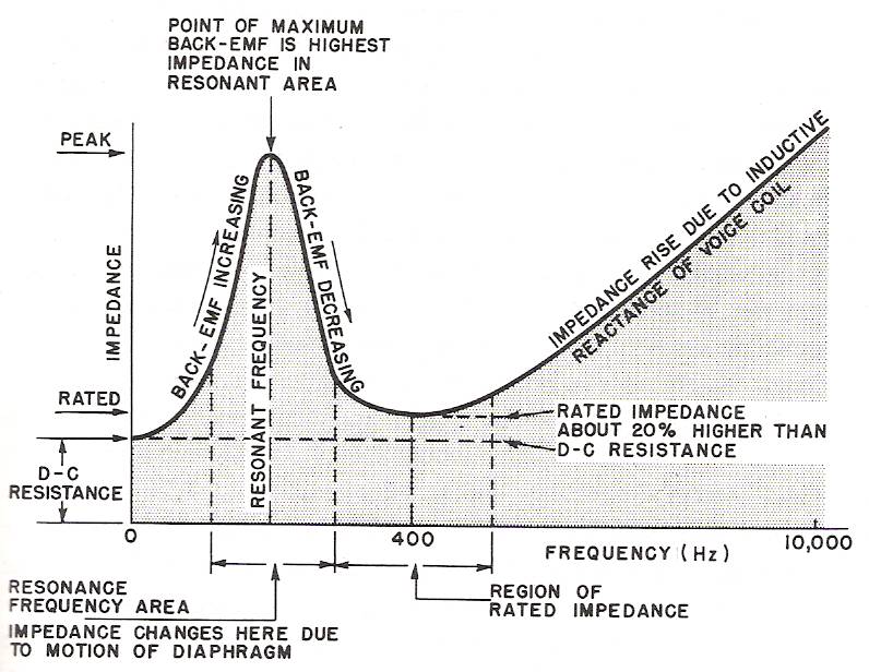

By impedance matching the HF energy on the cable is lost into the load.
What value do you assume for the load impedance?
A ribbon cable will have a fixed impedance/frequency profile, whereas the speaker impedance/frequency profile is dynamic. How then do you match impedances?

Easy load, 5.2 ohm. Resistive.
That may well be a rated or DC impedance, but a speaker's actual impedance isn't purely resistive and isn't constant, as shown in the figure in Ron's post above! Your cable may be ok for impedance matching to a 5.2 Ohm resistor, but you won't get much sound out of that :).

These are not coil speakers. They are ribbon planar speakers. The resistance is ruler flat through the spectrum.
ronv
Joined Nov 12, 2008
3,770
Resistance is the same of course, but not impedance. Think about it.. It's a coil. A coil has inductance so Z=2 pie F*L +R.
At audio frequencies and the low source impedance of the amp, the only thing your wire can influence is resistance. So if you like really loud music use thick cable. :D
My mistake. I meant impedance. These are magneto-planar, no coils. Although being more like a straight wire, I'm sure there is some self inductance somewhere.
Indeed there is. A straight wire has inductance. Hence its reactive impedance will change with frequency. The planar conductor of the speaker also has parasitic capacitance, which will vary with the distance of the conductor from the magnet and again change the impedance.
