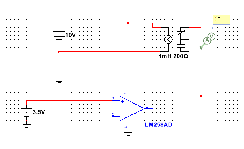

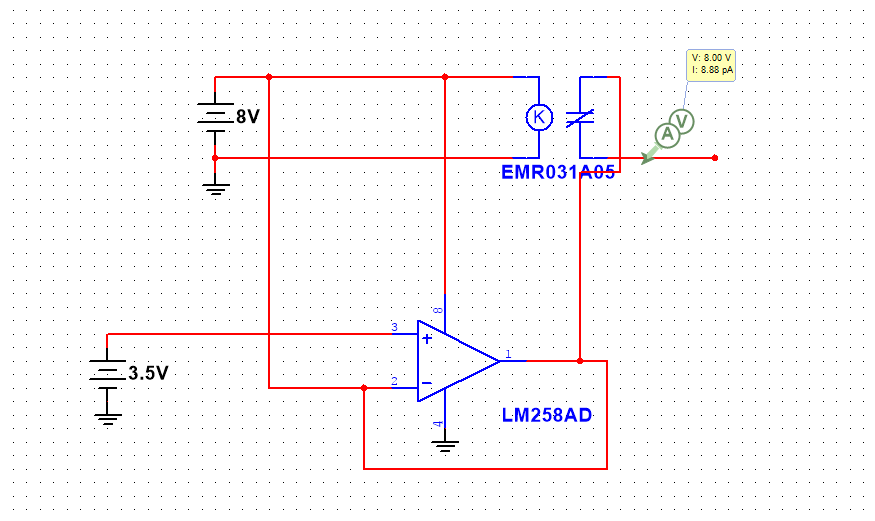

Thanks for all the answers. I'm trying to make some simulation for learning. but i still don't know where to start..
This is the only thing I've come up with so far..
Any example circuits are appriciated.
Edit: Would this work?
Edit again: And no it won't lol.. I get confused with op amps/comparators haha..

No it wont work, pins 1,2 are linked together,
This is the sort of thing you need,
https://www.google.co.uk/search?q=voltage+comparator+circuit&client=ms-android-sonymobile&prmd=isvn&source=lnms&tbm=isch&sa=X&ved=0ahUKEwiJzuns0O7PAhVhKMAKHcq7ACsQ_AUIBygB&biw=360&bih=512#tbm=isch&q=battery+voltage+comparator+circuit&imgrc=PEEvsIOjF-mGuM:
You need a fixed reference on the(-) inverting pin, like 3v, and alter the resistors on the non-inverting pin (+) to set the switch over point

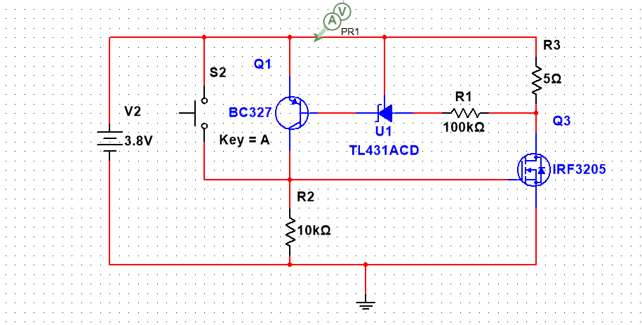

Great thanks, i only have a small issue. I want to replace the zener with a TL431 which has a 2.5v reference, but i don't get the results that i want. atm i have it like this for testing:
If i understand this correctly it should give me 2.5v, i.e the output should terminate if i go under 2.5v, and allow current to flow if i go higher, but even at 3.8v current still won't flow until i go up to 4v.. any idea why?
The TL431 "programmable Zener" is actually a comparator with a built in 2.5V Vref - and all in a TO92 package (and various SMD styles).
The input resistance is about 100k or so, that means fairly low standing sense current. Using it outside a nfb loop means the comparator will switch - but in the on state it can't go below about 2V, because Vcc and output are both the same pin.
You might get away with discharging a lithium cell as low as 2.5V, the datasheet I read says 2.75V - you can put a voltage divider on the comparator input, but it'll draw slightly more sense current.
