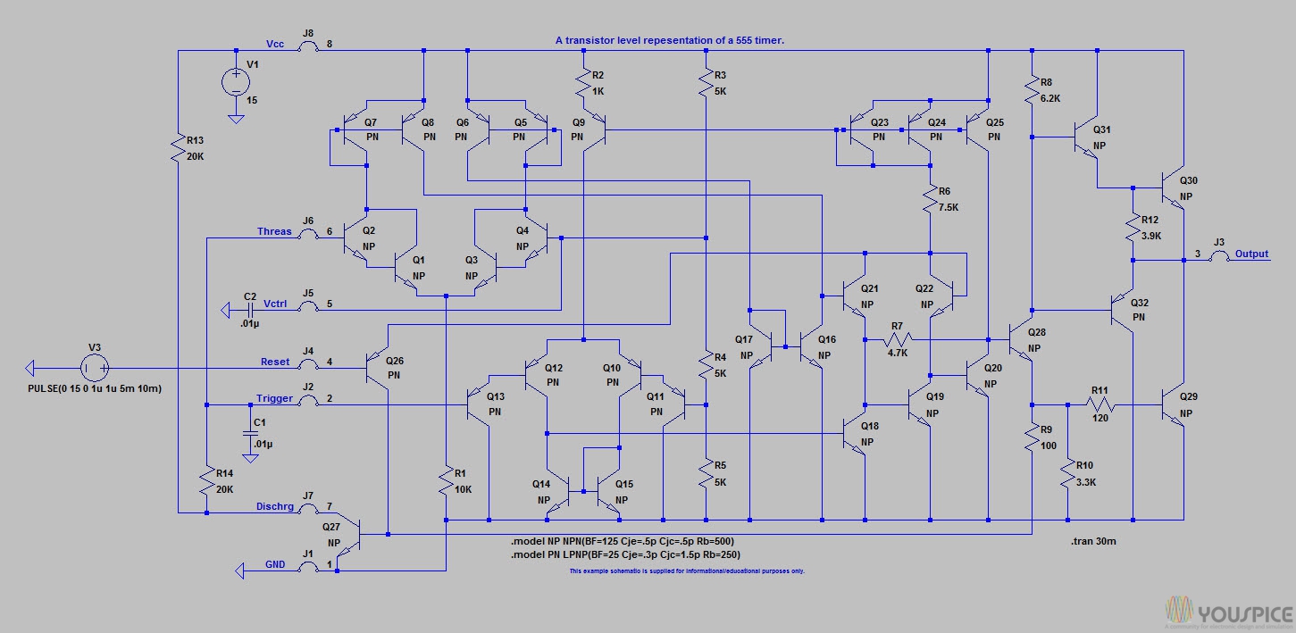

It's true you can get lost in them... but it makes sense once you organize them into blocks... it's two comparators going into a flip flop. The two comparators are connected to a resistive divider which happens to be 5k/5k/5k (not where it got it's name). Then there are two transistor - reset and discharge which controls the RC timer.
ci139
Joined Jul 11, 2016
2,037
?Q21 ?PNP -- . . . the Puzzle part is to get the Q23 drive all three -- Q21, Q24 and Q14 throughout the specified 4.5 to 16/18 V
(the below requires higher drive and supply currents than the actual thing likely due the speciffics of the 2N2222 2N2907 (and no device scaling (in this v.)))
