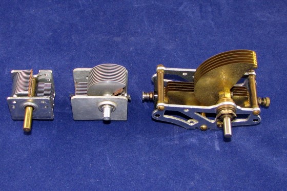

Hello.
The title of this post is in fact a comment that my "contraption" drew in the household. The homemade variable air capacitor does work quite well, against expectations. Made from 22/1,000" galvanized mild steel sheet, and painted clear acrylic to insulate the rotor from the stator. 10 rotors to 11 stators. The range is from 31 pf to 243 pf, which is useful, and is quite linear (see graph), thankfully. Still some finishing to do.
I cannot say that I have learned too much, yet, as a result of the exercise. I will be dismantling it again and testing it from 1 rotor / 2 stators and up, to see the effect.
It was a fun project!

I've never seen someone make a homemade variable capacitor just like the real thing.
You need to put a tuning knob on the shaft.
How did the cut the plates to be the same shape?
Would be nice of you to post it as a DIY instructable.
Amazing. Well done!
Congratulations! It is hard to face a question like that!! :(
I recall that there was a technique to linearize them in the lower end of the range with small trimmers but cannot recall how they were connected.
Otherwise there is also the chance to alter the shape of few of them to compensate for the lack of linearity or even to change the alignment of the plates in the stator. Just by shifting one a little and recording the resultant values, will tell how many and in what direction.
Pity is that I forgot all I knew about that!!
Around a week ago I found several variable caps like yours, coming from RF equipment. I was sure that they were binned years ago. So many tests I could have done with them!
Keep doing and learning in spite of...questions :p

That tuning gang deserves some kind of award :)
They manufacture them so the lobes aren't properly circular
Only for tuning gangs that are going to be interacted with through the radio's interface.
That's how they make them linear.

@MrChips: Well, actually there are two, and only two that I found on the internet (here and here), DIY tutorials on making variable capacitors. However, I already had the idea of what I intended to produce when I found them, so I pressed on with plan A. I do have some design plans I drew up, but as they are rough and in pencil (my engineering design instructor from years ago would have thrown them straight into the bin without comment and without changing his expression) I am hesitant to scan and post them. I will "clean them up" for that purpose.
Indeed, an insulated knob is an unavoidable requirement. I noticed while testing the unit that every time I touched the chassis the capacitance reading would go up by about 120 pf. Is the difference a reading of my personal capacitance?
@Art: The tooling is relatively simple, and building the unit requires only basic fabrication skills. Tin shears, files (2nd cut square, rat-tail for inner radius and a square smooth for final draw filing of edges), fine emery paper, a vice, drill, and anything that can stand in as a small anvil (my vice has a small one integrated). Also a guaranteed flat surface to mount the emery paper on (I used a square of thick glass), as the final, light surface polishing of the plates is done on this. Finally, a micrometer, though if washer thickness is a guaranteed standard in your location (unlike here), this is probably optional.
I had read that the elongated lobe design was used for attaining linearity, hence my employment of the concept. It seems to work. There is, no doubt, some rule which has to do with area of metal in proximity versus area not in proximity, in relation to total surface area of metal, I should not wonder. I am thinking about it; that is all I can say regarding. Has anyone heard or know about this? I notice neither of the tutorial links use elongated lobes. Odd.
Additionally, my stator plates are shaped to match the curvature of the rotor as much as possible. On one of those tutorials, they are just rectangular. It has me wondering what effect that might in itself have, in relation to the above ruminated, potential conjecture.
@MrChips: I notice your variable capacitor has slots cut into some of the rotors at certain angles. I wonder if this is an example of the sort of fine tuning for linearity that atferrari refers to.
Both tutorials also use aluminium, most probably because of the ease of cutting the material. I am not at all sure if better conducting material will in fact produce a more efficient capacitor, though it is plainly obvious that a capacitor of this kind - going extreme - would not work at all if made of wood!
Also, I am also considering proximity between plates. The gap between the plates of each component (on mine) is 118 thou, which gives an air gap of 48 thou between the rotor and stator plates when assembled (in practice, there are inevitably slight variations to this, of up to 6 thou, when measured with a feeler gauge on my unit). With this in mind, I am contemplating making another one (or modifying this one) in which the rotor surfaces are insulated with some thin plastic sheet and the gap is closed so that the insulation is brought down just into contact with the stators, in order to have the minimum possible gap, (ie; the thickness of the insulation) between plates. However, all this will not be before testing this one with less plates to, at least, "get a feel" for the thing.
I am reasonably optimistic it will work as is for my purposes (plus the knob, of course) in a radio circuit.
@THE_RB: A cat's whisker diode would make the whole crystal radio experience more or less essentially complete. I did not have much success with an attempt with the rusty blade / graphite version early on.
Finally, thank you for your comments and suggestions. I hardly think it is award winning stuff (my capacitor, I mean, not the comments! :)), but again, my sincere thanks for that positive note!
PS EDIT: I have just tested the device with my "mystery radio" coil. The results do exceed expectations. The first effect was anticipated, to an extent; selectivity is much easier and covers a good range of the AM band; a frequency card could easily be made for it. There is a bit of a gap off the scale at the highest capacitance, but this is an issue with the coil(s) inductance value not being properly matched. The completely unexpected result was a massive reduction in other station interference, applicable to using any of the coil taps, both on the antenna and detector coils. And the actual quality of the selectivity is improved across the range. In other words, it zeroes in on the stations and effectively "filters" out the background of a powerful nearby station that previously "intruded" on a good part of the range with the small "hobby" capacitor. Well worth the effort. My thanks for the advice to go ahead and use a variable air capacitor, thereby convincing me to proceed with what was initially only an idea I was "toying" with of making one.
