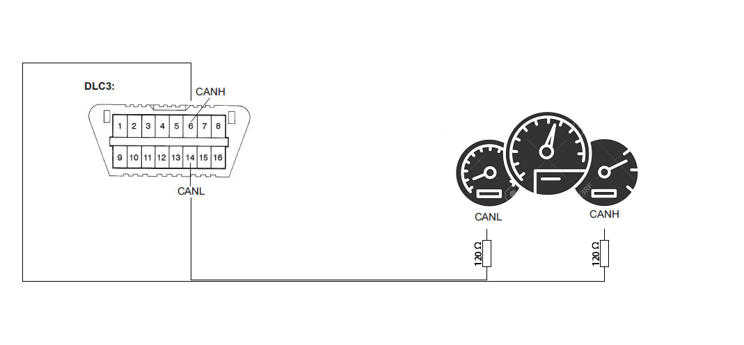

If you connect just the newer cluster to a scan tool via CAN bus, can you talk to it? If you do the same with the old cluster, can you talk to it? If you can talk to each ot them separately, you should be able to talk to them together..
Sorry i'm not following. Do you mean connect the newer cluster to pins 6 and 14 on DLC3 with the scan tool plugged in as well? And then try using the scan tool to see if I can get communication on the can tool?
dont forget the CAN bus lines need 120 ohm resistors on there as well.
The CAN main bus lines have 2 terminating 120ohm resistors in parallel according to the diagram I posted in post #15 What I tried is just taking some electrical wire about 80cm long from pin 14 and 6 from DLC3 directly to the CANH and CANL lines on the newer cluster, do I need to put resistors there somewhere? Does the extension electrical wire have to be of certain resistance?

CAN bus wiring is made up of a twisted pair of wiring and usually has a special insulation which provides a characteristic impedance of 120 ohms. It also has two terminating resistors, one at each end of the run that measure 120 ohms a piece. The total resistance on the CAN bus should be 60 ohms. If you look at Post 15, the diagram is laid out perfectly. You can then attach nodes to your CAN bus to communicate. So the DLC would connect on there which would be connected to your scan tool, and then the cluster can be connected on there as well. Both the DLC and the cluster must have power and ground going to them as well, otherwise they will not communicate. Each node must be 40" or less in length and I think max run is 140 feet. @Papabravo is a CAN bus guru and maybe he can chime in on this but that is what you need. If you try to connect in on your vehicle, the cluster will also need an address so that it can talk. I don't think it will be plug and play, it would have to be programmed into the system.
So where can I get this kind of cable? I can't seem to find any cable specific for this. I take it a twisted pair of cable from a cat5e cable won't be good enough (too thin possibly)? So should both ends of each wire from the twisted pair have to measure a resistance of 120ohm? So lets say I have a green and white cable. Do I measure both ends of the green cable and make sure resistance is at 120ohm and then the same for the white cable? If the resistance isn't at 120 for each cable, do I add a resistor in line at the end of each cable before it goes to the new cluster pin? So essentially making sure CANH has a cable with a resistance value of 120ohm and same for CANL? I've drawn a diagram below of what I am thinking
The current bus already has the two terminating 120 ohm resistors on it. The DLC branches out of this, and then if i branch out of the DLC pin 6 and 14, do I need resistance there too?

CAN bus is simply two wires twisted together. As mentioned, there is a resistor at each end. If the wires are yellow and green for example, the resistor would be attached to each of the wires at each end, forming a circuit. Yellow to resistor to green, just like in post 15.
if the vehicle already has it, you need not do anything else. I thought you were bench testing.
DLC is the datalink connector or OBD connector as you call it. Plugging in a scan tool is just a way to see if the BUS is recognizing the cluster.
Twisted pair wiring can be found in many places. Wrecking yard comes to mind first. Go and cut a length out of a car. Go to a heavy truck dealer and ask for a length of it. Sit down when they tell you the price. I think Digikey also sells it or Google it. Lots of places have it.
So for your diagram, it will be correct if you take out the resistors. Not needed. The only thing I don't know is if you need a gateway.

I just measured the resistance between the CAN-H and CAN-L wires coming out of the new cluster and it measures 120ohms. I think This means that it must have a 120ohm resistor inside the cluster on the can line. According to the diagram in post #15 there are already two terminating resistors at the end of each end of the can bus. So I'm thinking, what I tried to do by connecting the can lines from the new cluster to pins 6 and 14 on the DLC, the new cluster can lines if they have a resistor at the end of them will that cause an issue receiving messages?

I would measure the CAN bjs resistance with everything plugged in and see what the overall resistance is. You want it to be 60 ohms. You may have to remove a resistor if it is much less than that like say 40 ohms. Three resistors on line.
