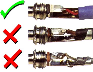

A common error for beginning solderers is to use too much solder. You want just enough to freely flow and wet the joint but no more, and without globs.
Here's an example of one good and two not so good joints.

Thanks crutschow, now that I look at it again, its a mess. Will take on board your points. Thanks a lot...
