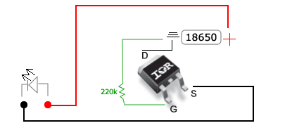

You have source and drain reversed. Body diode always forward biased.
Put in a current limit resistor or something will burn up.

wow. what an idiot. it works now! thank you.

Now it's correct but I need a resistor inline with the gate because my arduino gate trigger won't stop putting out 0.020v. If I use a pull down resistor it stops the led from lightly glowing, but then it doesn't work at all when I press my PWM button. So I've added the 10k inline resistor, but now I don't get enough power to the gate to get all the power I need from source to drain.
What else can I do?

The transistor should be off with 0.02V on the gate.
What is your PWM frequency? Might be a problem with the gate cap.

Try putting the 10K resistor between the gate and source. Connect your PWM signal directly to the gate.
Can you slow the PWM frequency to 10Hz? You'll be able to see the LED blink and gate cap shouldn't be an issue.
Have you inserted a current limit resistor for the LED?

I have been over several threads in several forums including this forum. I can not seem to get the mosfet to turn off. What I have here is really quite simple, but then again maybe I am too. Please forgive my ignorance...
This is my mosfet; www.irf.com/product-info/datasheets/data/irlr6225pbf.pdf
This is what I've done with it
Thank you, John
Connecting the mosfet backwards like this may have fried it.
