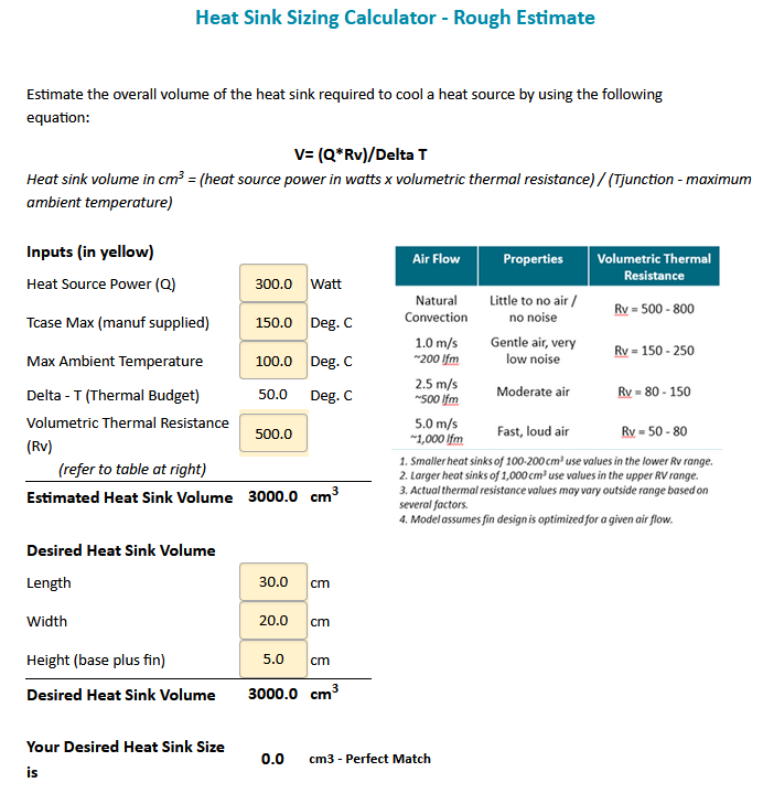

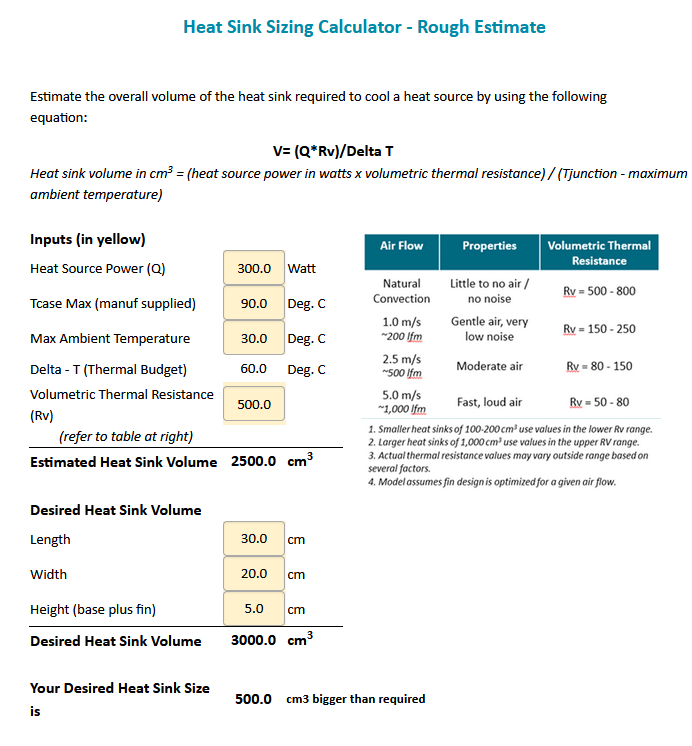

That 50-50-100 U slot, even with fans, is still shy of some needed sink.
600W is a lot of heat. That alone will raise ambient in a small room that has no AC.
Based on 100C(max) ambient and 150C(max) Tcase.
Without fans, need two of these:
300W air cool
300x200 x 50mm fin (4 fet per sink)
https://www.aliexpress.us/item/2251832835434662.html

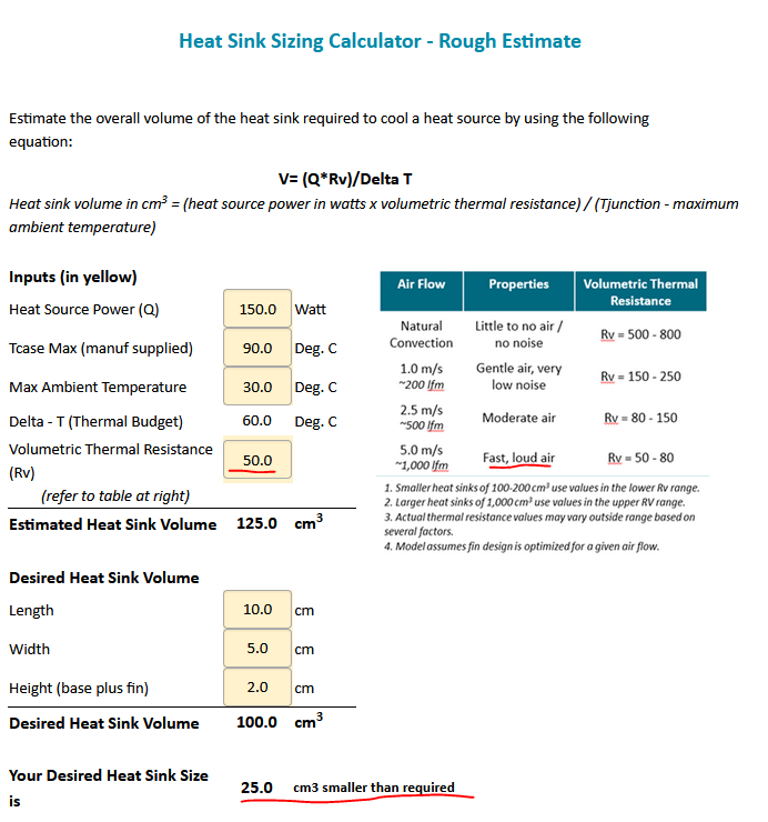

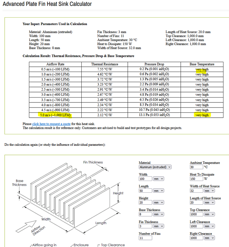

Caution. You must account for heat flow vectoring (how heat moves through the material). That U shape sink is meant to have the heat source mounted to the surface from which the fins rise from (base of fins). So, just be sure to mount two FET's per side, and for 300W of heat it needs fans (two fans, you can use lower cfm for less noise, and two helps mitigate a single fan fail to save your stuff from burning up). As for fans, I would mount a fan on each end and have them blow in cool air. Mounting location of the FET's is also VERY important (location and thermal coupling). I would mount them 25mm from the end and 25mm from the side. I would also make sure the mounting surface is very clean and flat, use some 600 emery to clean off and smooth the mounting surface, clean with some rubbing alcohol, use proper heat paste.
Also to note: if that U shape is not anodized, then the natural aluminum oxidizing layer impacts heat transfer to the air. Having fans should make that a non-issue, I was just noting it for you.
Aslo to note: you mention 30C max ambient, but 600W in say a small 12x12x8 room, even with HVAC cycling, can bring ambient above 30C.
I (we AAC forum folks) would like to see your final setup.
*** NOTE ***
That U shape 100x50x50 is a small sink. It looks big in Ali pics, but it's small.
Even with big flow fans, one side is basically just 100x50x20, and for 150W (2 fets on one side) it's not good enough.

There's another factor in play here. Nearly all heatsink specs, and that rough estimate, assume the heat source is fully and evenly dstributed across the heatsink base, not a near 'point source' eg 20 x16mm (PLUS247 package, smaller for TO-220). This can seriously impact heatsink efficiency, making it effectively 50% smaller or worse in many cases...
DC_Kid
Joined Feb 25, 2008
1,242
On that page that has the sink calculator, it has a back reference link to the math of sinks. I think the calculator accounts for some of the points you mention.

For the 300x200x50 sink in post #28, looks ok. Two FET's per sink fours sinks in total. Yep, 600W is a lot of heat.
Need a turbine to cool? 5m/s through a 2300mm x 1050mm duct is near 26kCFM !
For the U shape OP wanted to use, no good.
That U shape sink does not have fins that are 50mm tall. The fins are approx 20mm tall, maybe less.
That 100 x 50 x 50, 1/2 of it for two fet's (150W). Heat source is meant to be mounted under fin base, for the basic math calculators.
Note the #'s I used, and then look at that U sink.
Even 75W shows temps too high with hi-flow fan.
100mm is barely 4" long. 100x50x50 with fins that are 20mm or less, is a tiny sink.
