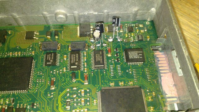

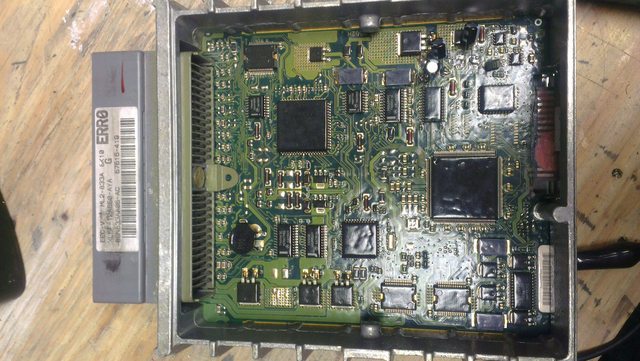

I have taken a couple pictures. You can see where I added new caps. They are doing some sort of power filtering, and when I replaced them it made a HUGE difference. in fact, for almost 2 weeks the truck ran like a wet dream. thought i fixed it, but it slowly went back to missing and bucking under load.
Now, the caps are still fine. I even replaced them again and no change.
Does anyone have any sort of knowledge as to what normally goes wrong with these, besides the caps? Its a bitch to work on, the whole thing is covered in dried silicone. I do know this ecm directly controls the voltage that drives the fuel injectors and the ignition coil.. and from the way it runs it does seem like a spark issue (i will get immediate full power and then back to missing all the time... its very instant and very random)
My soldering is a lot better than it looks too. I am tired and a little frustrated, if you can imagine.
And I will tell you, my biggest problem here is identifying the components. I can test most stuff, but without knowing what it is to begin with I don't know what to test. If I had a datasheet for this computer it would be done by now
