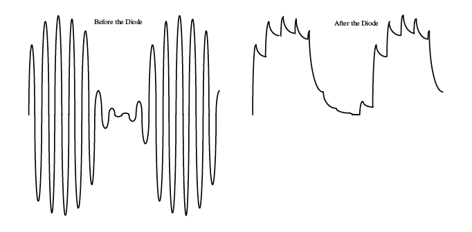

The general rule of thumb is 10:1 ratio of the carrier and modulating signals for AM.
This is mainly because of demodulation. With simple filters it's very hard not to have detectable carrier ripple in the demodulated signal at 10:1 with an envelope detector.
