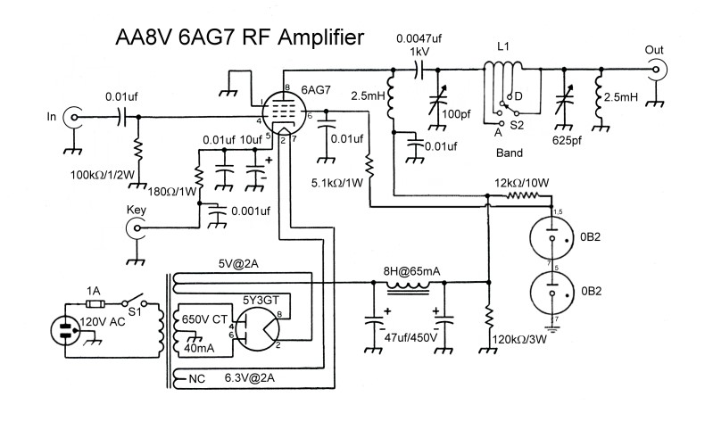

Does anybody use monstrous 600V capacitors anymore? All of my plastic film capactors are too small to be connected backwards.

I tried to locate an old schematic and I don;t think they are marked on the schematic. Usually there is a pictorial view and it could be marked there.The "outer foil" thing is new to me. How was the orientation shown on a schematic?
