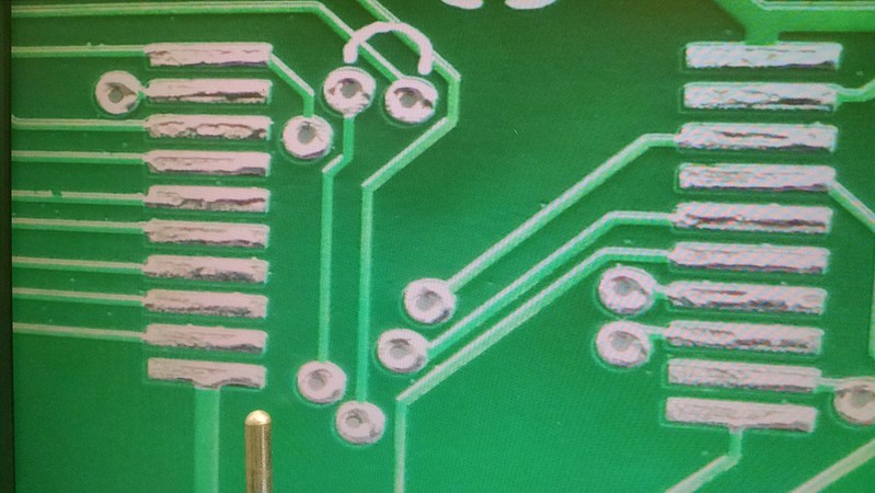

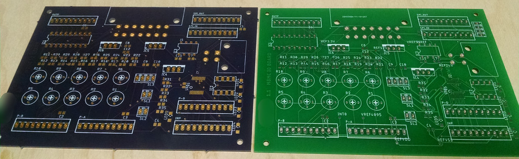

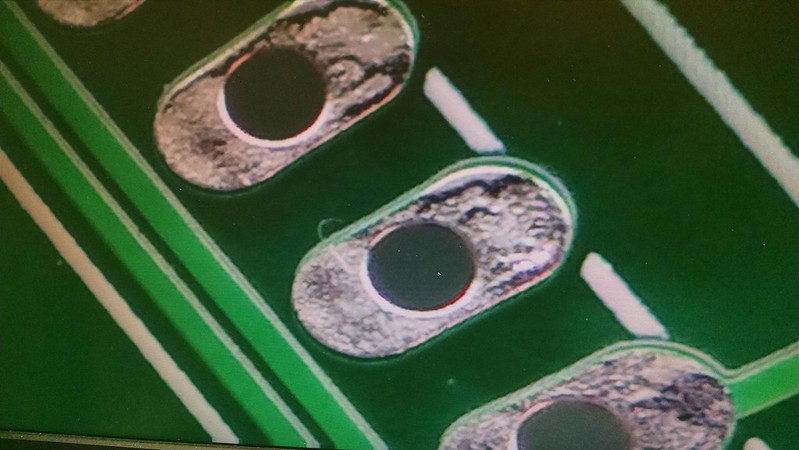

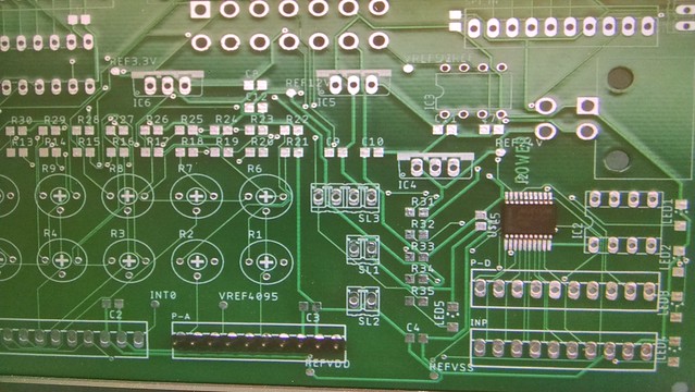

16,474
I ordered 5 of the first time buyers cheap boards from JLCPCB for my solar project to take a look at their product. The JLCPCB rev contains some fixes and upgrades from the original purple but both are from an Eagle Cad zip gerber and both are the base board with no additional finish options from the manufacturer.
Not great, not terrible in comparison with a higher quality board.
16,474

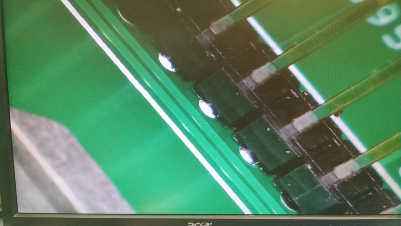

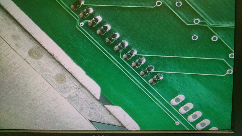

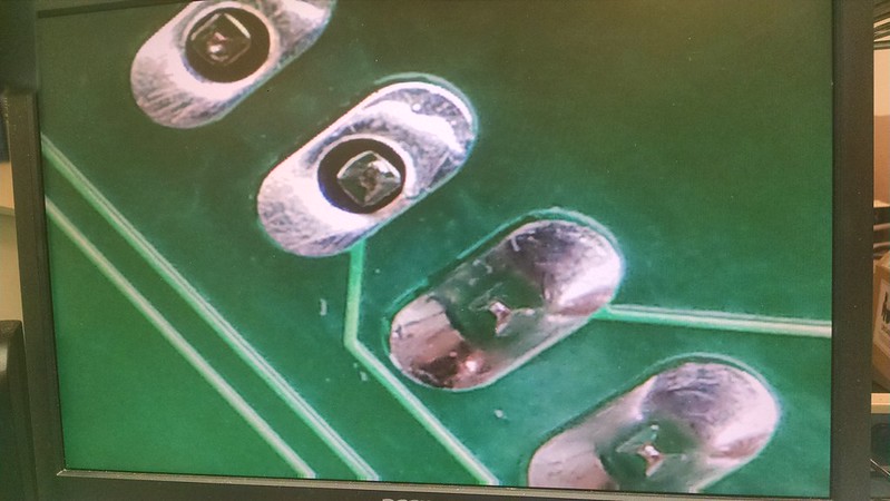

Started installing parts on the board.
Pin headers and PCB holes
Soldered a few pins to check clearance and alignment.
With that much clearance it's very important to use enough solder to fill the hole top to bottom with a temperature controlled iron.

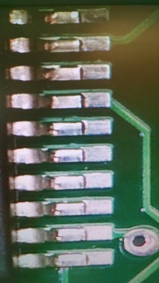

SMD device with hot air gun.
Solder finish is not smooth but seems adequate.
My grade would be OK with proper soldering but good luck with rework on this quality of board.
jpanhalt
Joined Jan 18, 2008
11,087
I also like OshPark, except the part where you can choose any color so long as it is purple. I really like red, but green is OK. On prototypes (the only type I have ever made), I find the purple too hiding of the traces I may need to change.
You also seem to be comparing HASL with ENIG. I would expect any immersion or electroplating to be smoother and better controlled. I do like the gold plating too.
16,474
Sure, I'm comparing HASL with ENIG (and board quaility in general) because that's the default option on their board without finish upgrades for each manufacturer. There's a very good reason why OshPark and others like them are more expensive. Once you upgrade the options on the low cost boards to match their finish and quality the price is much the same on normally priced orders.
