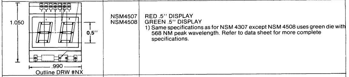

    Hi
    Looking for spec sheet National NSM 4507 smart 2-digit 7 segment LED board. It just has too many pins for power data and clock?
    The PDF that is floating around the Internet is only a summary sheet and does NOT show PINs etc
    If anyone has the other pages please let me know
    Thanks
    [​IMG]

    You are right about two many pins for serial communication. I'll bet the seven pins at the top of the picture are for telling the board which LEDs are to be lit. Usually a-f are used, going clockwise with a as the topmost LED, d as the bottommost, and f as the middle bar. There will also be a Common pin (or maybe two) for connection to either ground or V+, and I'd again bet that there is some type of address pin to select which 7-segment group you are addressing.

    well yes and no. Those are made to be cascated so I know exactly how to get 7 pins but I just dont know which is which. Those boards use simple bit shifting and are made to cascade to almost any lenght of digits. They use shift register internally and NO refresh as today's design. That is why those old LED instruments never show the typical blanking when you film them with cam corder... No refresh, they are solid ON direct drive.
    1 and 2 = power and GND
    3 and 4 = data and clock IN
    5 and 6 = data and clock OUT
    7 = PWM blank-out used as intensity control of the LED
    So here I have 7 but I do need to know which is which???
