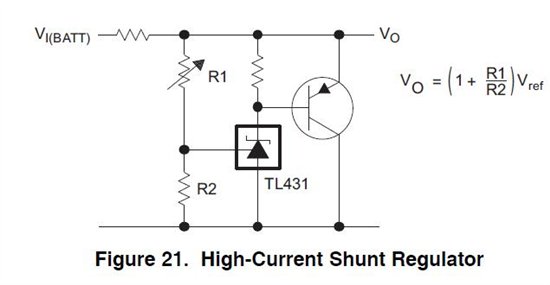

In general case the power loss is small only at digital stabilizers (like SMPS), but at the concrete ocassion I see the on-state will be extremely short for any starter, thus the power loss may be any. Then simplicity and trustability is the first hand choices and then I cant name any more appropriate circuit topology as following: input goes through n-ch mosfet Drain with an appropriate current qualification. There are plethore of mosfets having 125 and more Amperes. The output is the same mosfer Source via the very small but powerful resistor. Probably 125A*0.01 Ohm=1.25 V may be appropriate. From that mosfer Gate is coming out the reciproke Zener TL431 cathode, but anode to GND. The 431 Gate is connected to mosfet Source. The mosfet will need the cooler for 125 A*(0.1...0.5)Ohms=13-60 W. If natural air flow then each Watt demands the 26...40 cm2 area of both side taken together cm2. Reference: http://1.bp.blogspot.com/-G3KRUK7ZC...RcguM0/s1600/TL431_MOSFET_PS_skeleton_sch.png
Reference using the bipolar transistor(but then 125 A looks biggish) https://www.diyaudio.com/community/attachments/tl431-jpg.405657/
