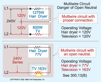

The issue isn't low voltage, it is high voltage. With the neutral open, you have effectively the loads on the two legs in series across 240V. Depending on the current draw, the midpoint (normally where the neutral is connected) will move. One set of loads will have low voltage across it (won't usually kill things, but some motors are sensitive to it) but the other will go above 120v and will blow things.

That's not how they are connected. There is no path from L1 to L2 as the picture shows for a 120V branch.

120v is from a hot to the center tap of a 220v transformer. So, if the connection to the center tap is broken (or high resistance, the pictures in post 28 are exactly correct (simplified). In reality, there are many appliances and lamps in parallel with the hair drier and many appliances and lamps in parallel with the TV.

I guess that if you extend the center connection back to the neutral in the panel, then this could happen. However, both items would have to be in the "on" state for this scenario. Also, they are in series, not parallel. For this to occur, they would have to be on 120V breakers on opposite sides of the panel. This kind of situation can have fatal consequences.

With a three prong outlet, the ground wire and the neutral are connect at the panel, so with the neutral open, there still is a connection path.
However, the picture in #28 implies only a two pronged outlet. With the neutral open (and no ground wire), the only path back to the panel is thru the two hot lines. Since the two devices are in series, to complete the circuit, both devices must be on. So, using the picture, someone wanting to watch a football game would have to yell to his wife, "Honey, can you dry your hair for the next three hours?"

But a hair drier and a big screen tv no longer consume the same power as they did in the days of CRTs. Be careful which load you select as your voltage divider.
