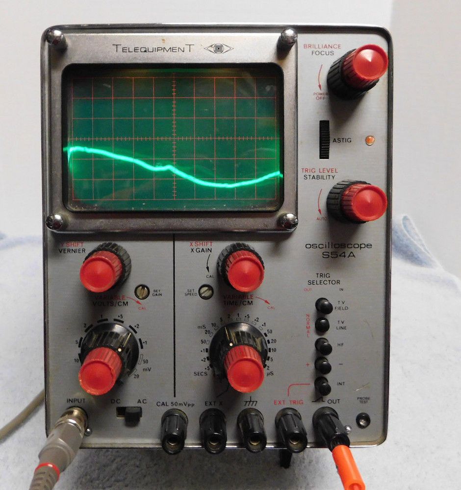

Lorne Allaire
Joined Apr 17, 2017
26
That's great. I always wanted to learn how but never had the opportunity. They've always intimidated me with all the controls.
I adjusted my oscilloscope as you described and also by page 4 of the manual "First-Time Operation".
BRILLIANCE = Fully anti-clockwise
FOCUS = Central or there about to get clearest image
ASTIG = Central
TRIG LEVEL = Fully anti-clockwise - AUTO
STABILITY = Fully clockwise
TRIG SELECTOR = all buttons except lowest out
X SHIFT = Central
X GAIN = Fully anti-clockwise
VARIABLE = Fully clockwise
TIME/CM = 5 mS
Y SHIFT = Central
VERNIER = Central
VOLTS/CM = 100mV
DC-AC = DC
And this is the waveform I got :
MrChips
Joined Oct 2, 2009
35,319
It would appear that both vertical VOLTS/CM and horizontal TIME/CM calibrations are off.
The first thing you want to do is tweak the SET GAIN and SET SPEED.
Set VOLTS/CM to 50mV.
Adjust SET GAIN so that the peak-to-peak trace falls between two horizontal grid lines. (You may need to adjust Y SHIFT as well).
The CAL 50mVpp frequency is 60Hz. This is a period of 1/60Hz = 16.667 ms.
With the TIME/CM set to 5ms, 17ms would be three divisions plus one small tick mark on the horizontal axis.
Adjust SET SPEED to achieve this. (You may need to adjust X SHIFT to bring one of the signal edges to line up with a major vertical grid line).
After you have made these adjustments, remove the input signal and adjust Y SHIFT so that the trace falls on the middle of the screen.

Lorne Allaire
Joined Apr 17, 2017
26
My baseline is in the middle of the screen.
I set VOLTS/CM to 2 but the signal went off the screen.
I set it to 5 and got a signal you see below.
Probe is connected like this
Oscilloscope shows this set to 5.
I measured the voltage with my DMM at this capacitor and it read 4.81v.
