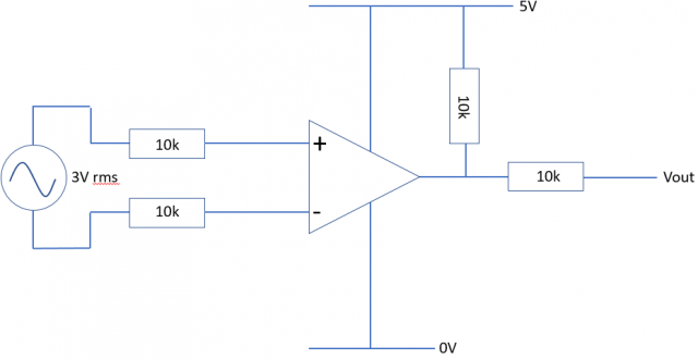

Hello,
I have a problem using an LM339N - I'm not familiar with this device, so I'm hoping it's just a configuration mistake.
I'm attempting to convert a 3Vrms sine-wave at 600Hz to a square-wave between 0V and 5V.
I've set up an LM339N with a 5V and 0V supply (to pins 3 and 12) and have an a.c. signal source connected to one of the device comparator's inputs with 10k current limiting resistors on both inputs. The output of the comparator has a 10k pullup resistor to the +5V supply and a 10k current limiting resistor.
When I measure the output, instead of the 0V to 5V square wave I'm expecting, I'm getting 2.5V to 5V.
Can somebody explain to me why it's doing this, please?
Thanks :)

Hello,
thanks very much for replying so quickly.
Here's my circuit:
I'm measuring the output with an oscilloscope at Vout, relative to the 0V rail. The input is from a signal generator; both instruments are mains powered, so there's probably a common ground connection, despite me showing the ac signal isolated.
Apologies for the dubious quality of the diagram - I had to draw it in powerpoint...
Thanks :)
crutschow
Joined Mar 14, 2008
38,589
One of the input resistors needs a ground connection for the LM339's input bias current.
You don't need the 10k output resistor.
The current is already limited by the 10k resistor to +5V.

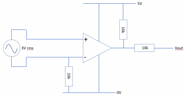

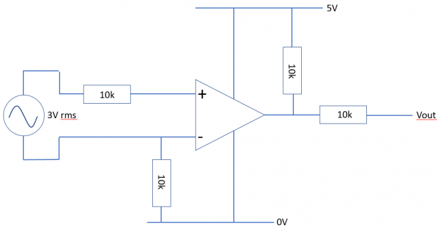

I originally tried this same circuit with a 741 as the comparator - received wisdom at the time suggested that an LM339 was a far better choice - could anybody recommend a better choice again?
I'm still not entirely clear about whether or how to ground one of the comparator inputs - I'd be very grateful if someboy could advise on which of the following (if any) would be the best approach:
...with the inverting input tied to ground via a 10k resistor:
...with the inverting input grounded as above, but with the current-limiting resistor removed (the above looks like a potential divider to me, which I'm pretty sure I don't want):
...with the inverting input grounded and no input resistors - hopefully the input impedance of the comparator is high enough to prevent the ABS system being affected by it:
Thanks very much for your help with this :)
crutschow
Joined Mar 14, 2008
38,589
I would use the first circuit except move the 10k ground resistor to the left side of the input resistor.
And remove the 10k output resistor.

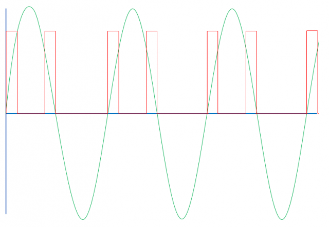

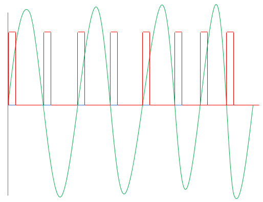

I went and saw how things panned out and they were both good and bad...
This comparator feeds into and arduino, which is counting the pulses to calculate vehicle speed - it then feeds a speed signal to the ecu and the speedo.
Up to this point, the speedo has shown zero - I believe this was due to the comparator not dropping to zero and, hence, the arduino not recognising the pulses (it triggers an interrupt and has to see a full rise from zero to five volts).
Now, the speedo is reading about double what it should be, (which is a giant leap forward, to be honest). I assume this means that the 2.5V problem has gone away but I suspect that the sensor signal is actually going outside the 5V rails of the comparator and the comparator is doing that weird thing where it switches back to zero when the signal exceeds the supply rail, a bit like this:
...again, apologies for the diagram - I haven't got my scope handy to test the circuit properly, so this is from memory.
I need to attenuate the input signal by the looks of it, but is there an easy way to do that using a potential divider on the input(s) somehow? Would tying the non-inverting input to 0V via a 10k resistor work?

0x10c
Joined May 18, 2018
10
I can't seem to edit my last post - not that it really makes that much difference, but the over-driven comparator output almost certainly looked more like this:
