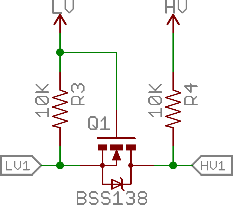

An NMOSFET with 2 pull-up resistors will work. It's bidirectional. Not super high speed but your use doesn't seem to need it. I've used 2N7002s and BSS138s. SOT-3 is about as small as you can get. Just about any low power NMOS FET will work. 402s are pretty small too.
[edit] you can also tweak the PUs for lower current draw but 500 uA is ok for most of my uses. Lower PU values allow it to run at higher speed. with 10K I can get about 100KHz with super clean square pulses. Above that the form starts to degrade but still usable to about 1 MHz[/edit]

I don't need the bidirectionality, so your circuit can reduce to a single FET and pull-up resistor (to HV). But I don't want the passive leakage through the pull-up during standby. That is what I am trying to avoid.
This should work using two small SOTs (with internal resistors) and a pull-down resistor:
