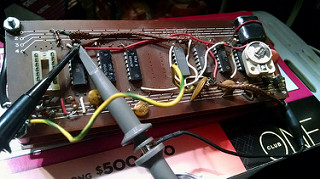

After decades in a junk box it's time for the rebirth. Cut the end off an old USB A to B cable and solder the 5vdc wires to the board. Check the power input for shorts and plug it in to a USB port for power.
It seems to know that time as passed (2001, I'm sure I built it in the early 70's) but the time-base is not working correctly (no output).
Found and fixed a few loose solder connection and adjusted the crystal trimmer for the time base.
Crystal-controlled multivibrator with series-resonant crystal.
https://ntrs.nasa.gov/archive/nasa/casi.ntrs.nasa.gov/19720000155.pdf
Bingo, we have the correct frequency from the quartz crystal.
That signal goes to the first divider stage of 3 7490 counters (2 in divide by 5 mode, 1 in divide by 10 mode )
for a 1khz output that feeds into another counter stage.
That looks good. The rest of the circuit has a 7400 for the gate functions with a 7474, 7490 and 7492.
Can't remember exactly how that worked so I'll have to trace that circuit later.
