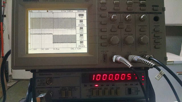

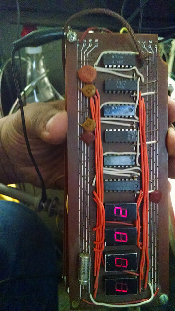

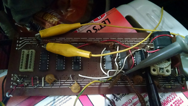

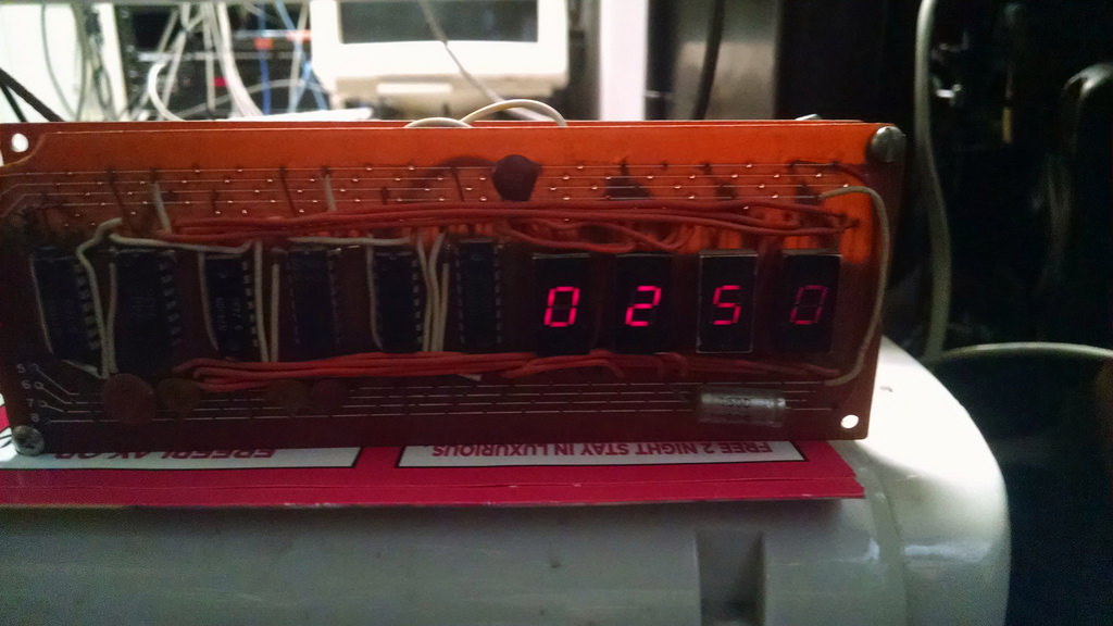

After decades in a junk box it's time for the rebirth. Cut the end off an old USB A to B cable and solder the 5vdc wires to the board. Check the power input for shorts and plug it in to a USB port for power.
It seems to know that time as passed (2001, I'm sure I built it in the early 70's) but the time-base is not working correctly (no output).
Found and fixed a few loose solder connection and adjusted the crystal trimmer for the time base.

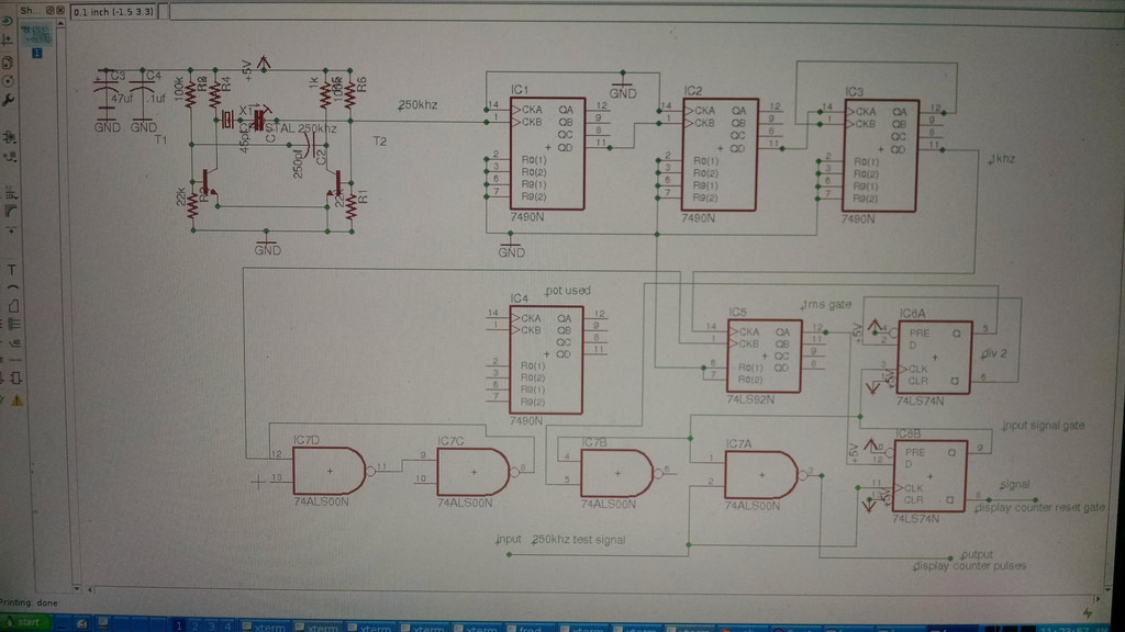

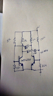

Crystal-controlled multivibrator with series-resonant crystal.
https://ntrs.nasa.gov/archive/nasa/casi.ntrs.nasa.gov/19720000155.pdf
Bingo, we have the correct frequency from the quartz crystal.

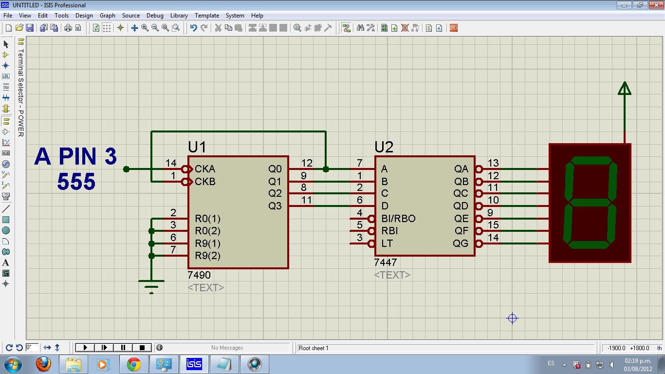

That signal goes to the first divider stage of 3 7490 counters (2 in divide by 5 mode, 1 in divide by 10 mode )
for a 1khz output that feeds into another counter stage.
That looks good. The rest of the circuit has a 7400 for the gate functions with a 7474, 7490 and 7492.
Can't remember exactly how that worked so I'll have to trace that circuit later.

Reversed engineered one of my own devices.:oops:

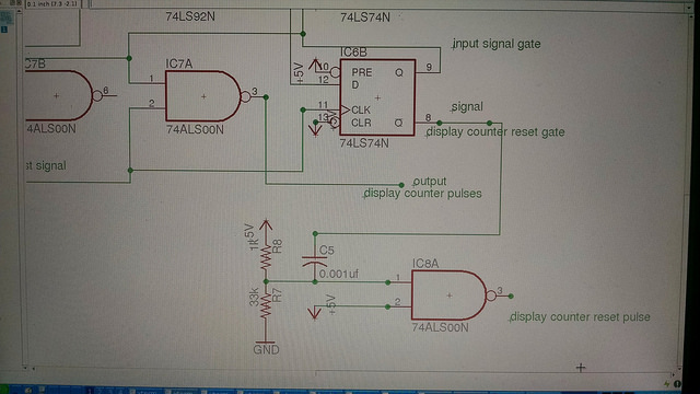

Basic clock and gate circuit traced.

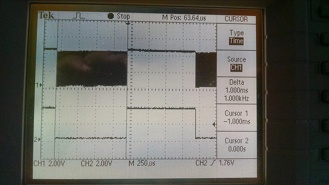

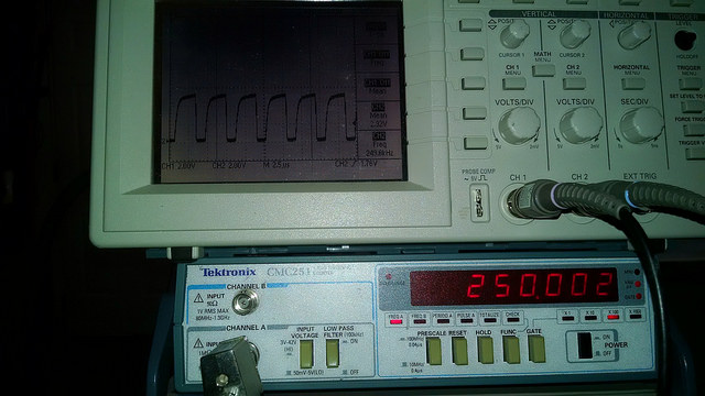

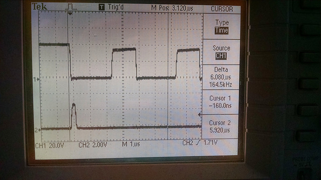

Adjusted the xtal trimmer for a 1.0ms gate using the TEK period count function.

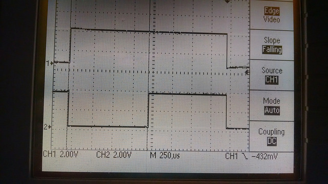

IC7A3 display counter pulses #1 and IC3 pin 11 1ms gate pulses #2

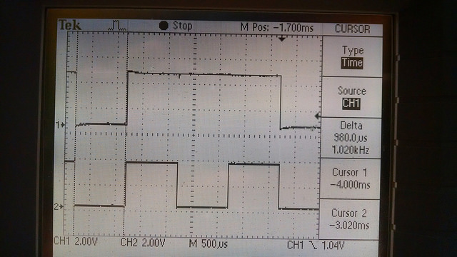

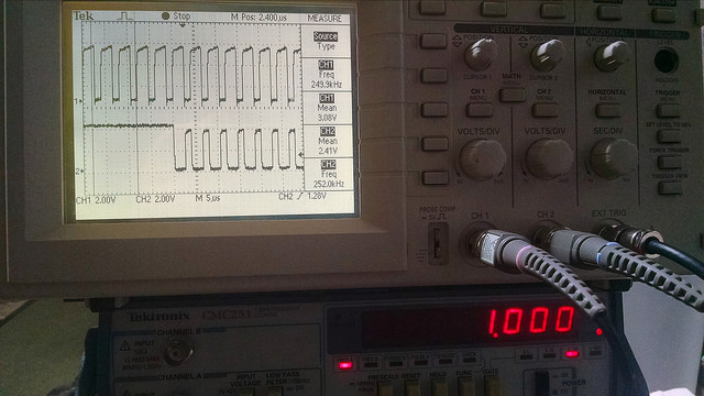

IC7A3 250khz input #1, gated output signal #2

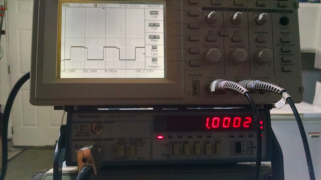

Input signal (tapped the 250khz clock for testing) and gate.

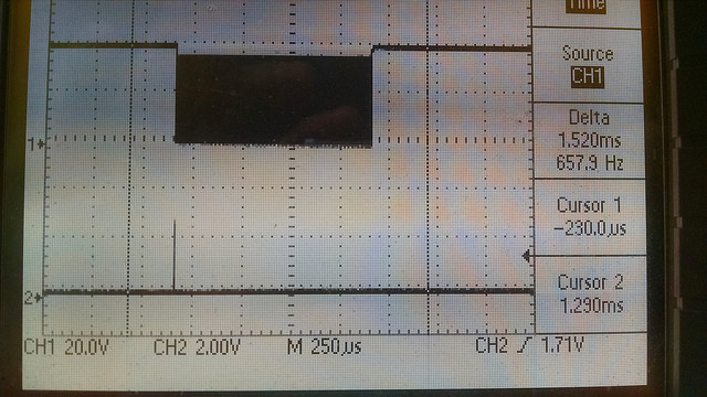

IC8B8 display counter reset gate #1
IC7B6 Another gate signal #1 that I not sure about it's original use.:confused:
The display reset gate signal wire (yellow/green stripe) is not connected to the display module, it was broken off at a solder joint somewhere on display board in the distant past so tracing that circuit will be the next job.

Finally working again after repairing two broken lands and wires.
counter reset gate circuit. Falling edge input, positive pulse output.
#1 1ms gated signal IC7A3 from frequency counter input IC7A2, IC8A3 #2 pulse output to reset display counter chain.
Detail: IC7A3 output to 7490 counter input #1, IC8A3 counter reset pulse #2
250,000hz input (from its xtal timebase) to output display in khz.
The rest of the circuit is just 4 9490-7447 seven segment counter and display stages with the reset signal IC8A3 connected to pins2&3 of the 4 digit
7490 cascade.

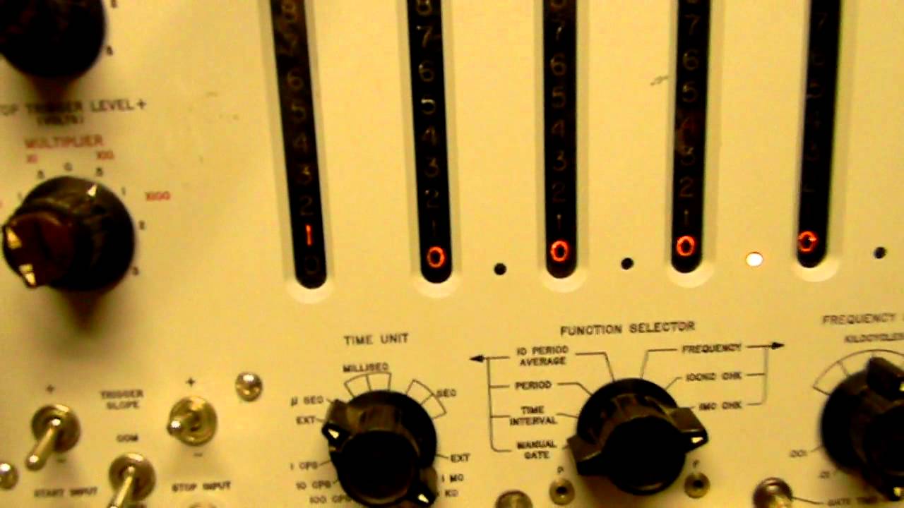

Now, in my garage, I have a one decade counter/ display "module" with just 4 tubes for the decade counter and ten neon bulbs for the display.
Now, that's retro... :)
In tech school there was an HP counter with the 10 neon bulbs per digit. I think that was the same unit that used phantastron circuits for the divide by 10's in the timebase.
Phantastron:
http://www.radartutorial.eu/17.bauteile/bt52.en.html
