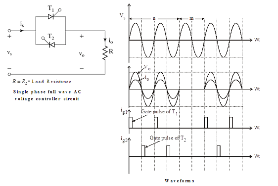

1) Triac Dimmer Circuit. just chopping the wave. same as OP... cheapest and mostly abused one.

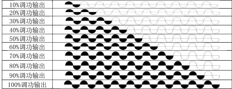

2) removing few or all cycles out.
This is on off but you switch off or on the full cycle, 60Hz we have sixty of them a second, 50Hz etc..
how many is off and how long to wait can be explored and tested using micro controllers. (this is like slow control if you try to have to much steps.
for 10 step, resolution, variation the control cycle will repeat 60Hz 6 times, 50Hz 5 times
for 5 step, resolution, variation the control cycle will repeat 60Hz 12 times, 50Hz 10 times etc
3) Doing what we do in digital DC world with AC. PVM the actual signal. yeaaay...
this is same as what @Mahonroy mentioned as option 3 but NO rectification. I need to keep both sides of the signal.
and what I am doing at the moment is similar to what @Mahonroy suggested but two of them at the same time.
these were originally design ideas of Motorola (umm Freescale, nope NXP now).
images are from my notes. (i will try to find the document.if i have time)

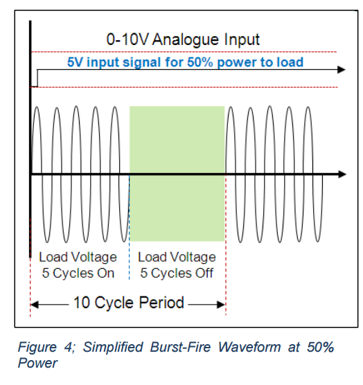

As a late reply to the OP, I came across the interesting app note from PicMicro AN958 and its companion AN954.
Outlines the details of a Triac replacement for a Adj Mech Thermostat using burst firing to prevent EMI etc. Another feature, if needed is auto shut down after a prolonged period.
It uses a small 10f or 12f Pic, The App also includes code.
