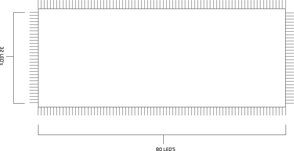

OK so I have a table (7ft long by 3ft wide) that I want to put in an LED Border. the border will be 2 inches from the edge and the LED's will have a 1 inch gap between each. Total there are 224 LED's in the border.

That's basically everything I think. Here's a picture of a rough copy of what It looks like
Sorry about the giant picture and the crappy drawing (the best I can do)
If theres anything else thats required let me know and post the info. There's a lot of other components going into this so after I get over this hurdle I'll keep you posted on my progress :D

So I made kind of a rough drawing of what I think is right. The resistor calculator said that 3 LED's in series would work with a 82Ω resistor. I don't think it will because the Vf is 3.5 so after 2 LED's there isn't enough for a third. So I went and did the calculation with 2 LED's and it says I need a 270Ω Resistor. The battery is the only thing I could get to show my point but there should b a wire with positive and negative so thats what that is. It's 1 of the 6 outputs I have. And What would happen is I would continue to run the LED series until I reached the end of the border so just image that the chain keeps going until I have about 75 LED's all together.
The last question I have is what to wire for the last LED in each series. I just run wire to the negative wire from the output right?
I'm assuming that this will all work so please correct me if i'm wrong or let me know if there is a limit on how many series circuits I can have connected to each output or if I need anything else put on this circuit to make it work let me know. As always thanks for all the help :D
Joe
Wendy
Joined Mar 24, 2008
23,798
LOoks good from here. When it is working measure the voltage across each resistor. Use ohm's law, plug in the numbers, and you have the current, which you can tweak if you need too. You have the basics down though. The 3 connections on the bottom are connected together.
