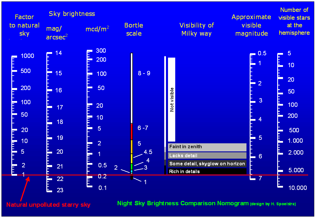

LEDs:
I had no idea 18mA LEDs would be so bright!! I was trying to estimate based on mcd, so I just looked at the LEDs with the lowest mcd on this website : https://www.superbrightleds.com/cat/through-hole/?view=standard (mcd values of 100 and 20mA forward currents) and figured those would be around indicator LED brightness. (Though maybe I should have taken into account the website name of “Super Bright LEDs”- as they say, hindsight is 20/20!)
After further research, it seems like 50mcd is a better target for the LEDs, maximum? I just want it to be visible (during twilight) that the lights are glowing, not too bright or obtrusive. After all, the stars in the night sky are faint, and we astronomers are sensitive about our eyes- take a too-bright light to an astronomy event, and you just might get lynched! (Though I will admit you could be on to something there, joeyd999; a quasar cape would certainly make an impact! :) ) Lower mA is great too- I definitely don’t want to lug around 20 batteries.
The question then becomes how to find the proper LEDs- seeing as for the design it’s pretty important for them to be through-hole LEDs, and they’ll also need to be able to ship quickly so that I can get them at least a few days before the party. (Unless there’s some kind of a physical store that would stock them- I doubt it, but if one of you has knowledge to the contrary, I’m all ears!) Otherwise, any recommendations for where to get them?
It’s looking at this point like I should probably not bother with trying to have different star colors, except for maybe handpicking a few LEDs to represent the stars that are known for their intense color (Betelgeuse, Antares, and a few others). That way I don’t have to worry about finding different color LEDs that match, and anyhow I need to remind myself to keep it simple!

TieDyeAstronomer
Joined Oct 1, 2017
3
@Bernard
50mcd is probably about right for the brightness. I finally found a chart that compares candelas and millicandelas to the brightness of things in the sky, so I have a better understanding now of what the various mcd numbers correspond to:
50mcd is just about the brightness of the night sky in an extremely light polluted city center. (You’d be surprised how bright that can seem when you’re in a totally dark environment.)
It seems like the mA and mcd values of an LED aren’t all that related- I could buy a 100mcd LED and a 36000mcd LED that both have 20mA forward currents ( https://www.superbrightleds.com/mor...egree-viewing-angle-800-millilumens/343/1290/ and https://www.superbrightleds.com/mor...hole-led-w-15-degree-viewing-angle/4044/8764/ ) Maybe the difference has to do with viewing angle and/or efficiency?
In any case the LEDs you suggested from Electronic Goldmine look just about perfect, and somehow manage to have a far lower price than any I’ve seen!! The cool white, warm white, and yellow LEDs are actually the perfect star colors too. Thanks for suggesting them!! I’ve emailed to ask what the mcd is since it wasn’t listed in the description, but if I don’t get a response soon I think I’ll order them anyway, because from looking at the photos I really doubt they’ll be too bright unless the photos are significantly underexposed.
I notice they do have a high mA rating, though, at 25mA. According to what #12 said, that would mean I’d need 25 AA batteries, right? That’s not good at all. Is there something I can do about this, or do I need to find other LEDs?
