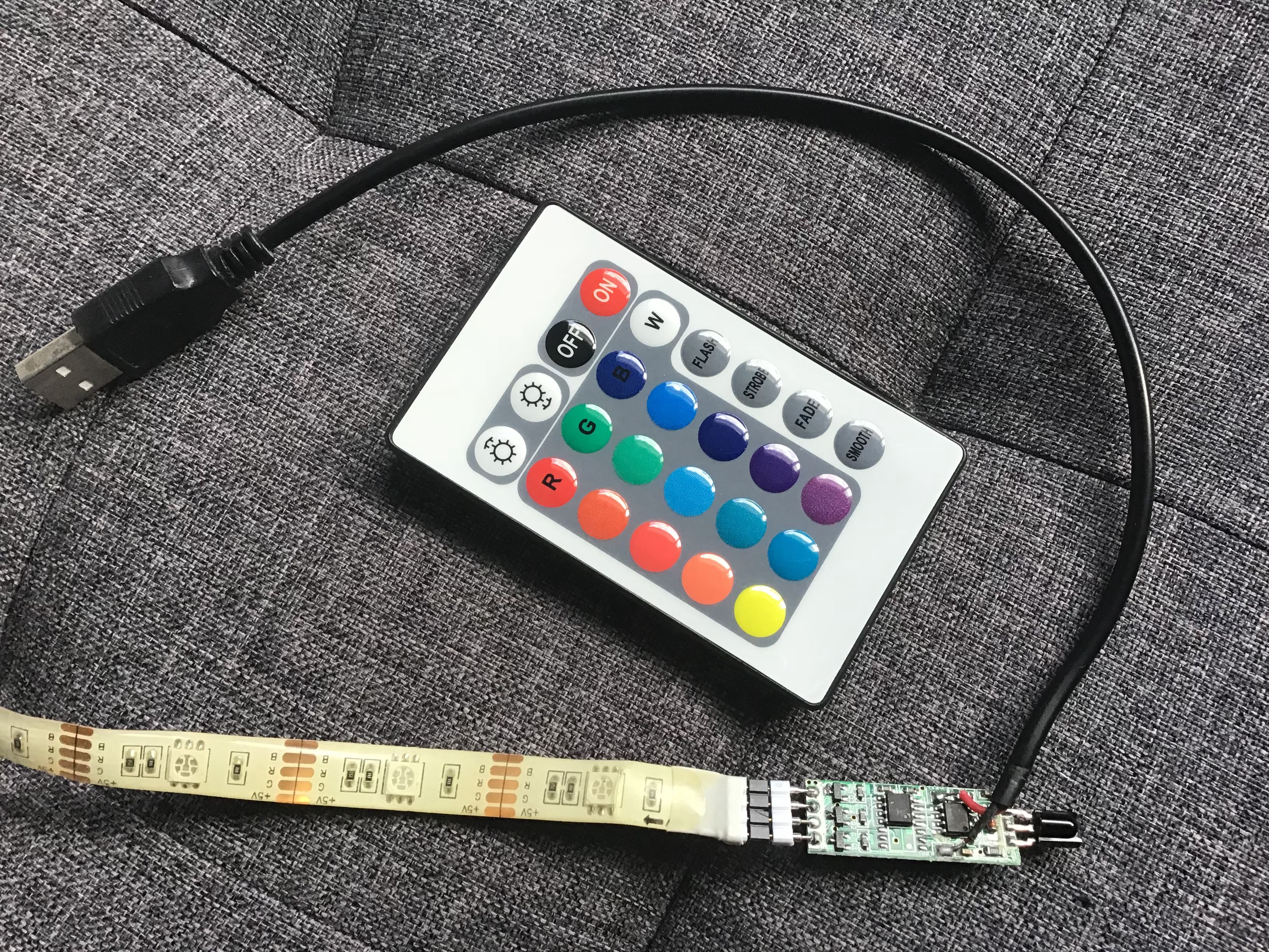

About 18 months ago I fitted LED strip lights behind my computer desk while moving in new furniture and an LED controller lead with an infrared receiver connected to a free USB port at the back of my PC. When I got Oculus Rift I had to disconnect the strip lights because I needed the USB extension lead I was using (as the LED controller lead is too short) and I left it off for a long time unused. I've now got a new USB extension and plugged the strip lights back into the PC but the LED's no longer light up.
I've tried the extension lead with my mobile phone charger and the lead is fine. I've tried replacing the battery in the remote control to actually turn on the lights, since it's the only way I can, but still can't turn them on. I have no idea if the remote controller even works as there's no other way to test it but with a new battery in it's probably fine.
I've also tried plugging the strip lights directly into a USB 0-2 4A connector on my power socket extension, thinking that perhaps the USB ports on the back of the PC aren't working. But then I've also tried plugging a memory stick into the extension lead and that works just fine.
So either the strip lights have mysteriously stopped working because I've not used them for nearly two years or the LED controller lead is faulty or the remote controller is faulty. Either way I have no other means to test them to see what the culprit is. Other than buying new strip lights of course but then I'd have to dismantle half my bedroom to get at the back of the desk now!

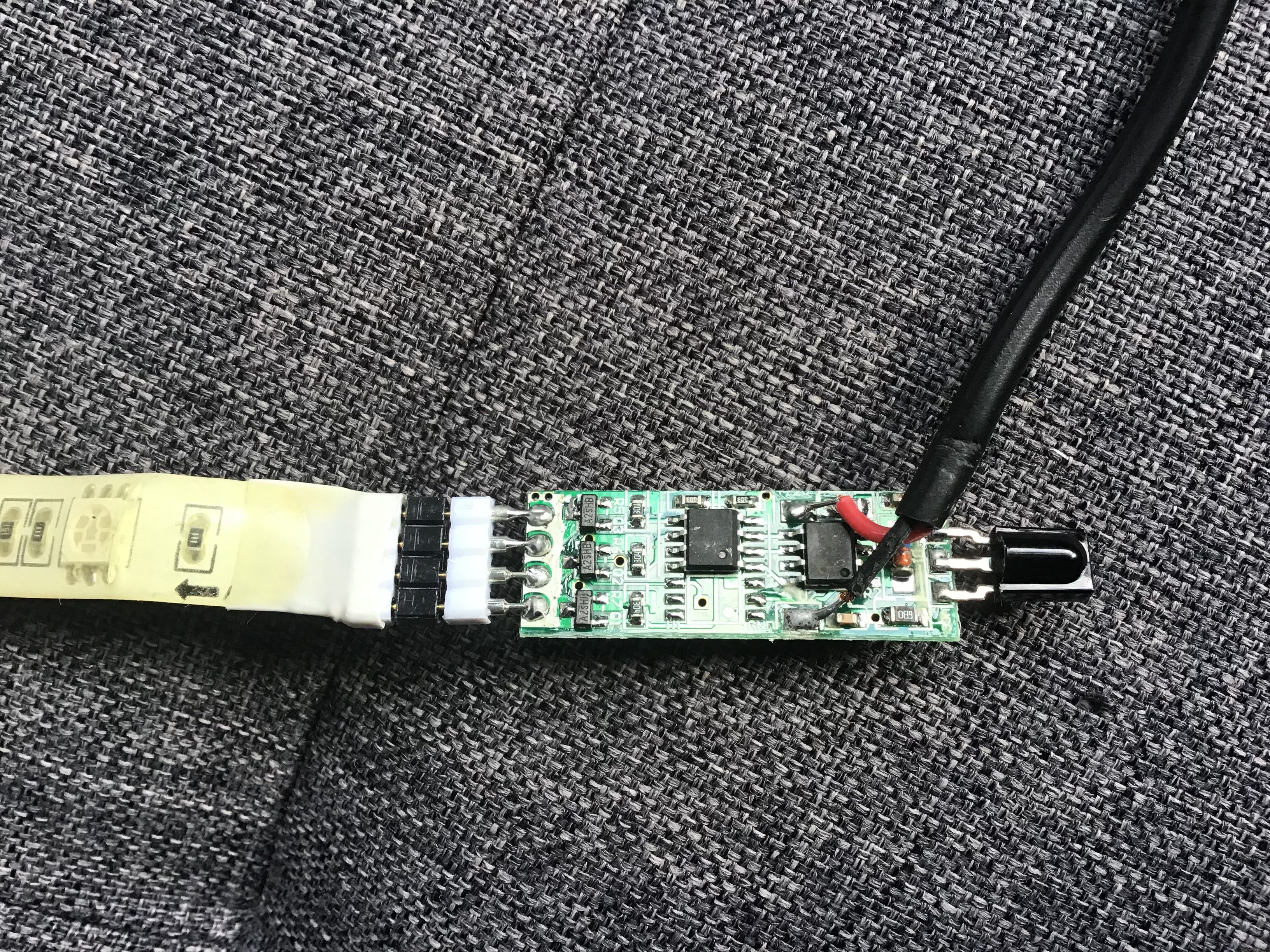

Would be nice to see the LED strip connection point. The LED's are likely just fine but confirming this by applying power to the strip alone would point more solidly to the controller or remote.

My apologies for the late reply. Also sorry for the rubbish photo but it wasn't easy getting my iPad down there to take this picture with a torch! So I've got 4 pin holes, if I connected a 12v transformer to the bridge between the strip and the LED controller which pins do I connect the negative and positive to?

Do you have a multimeter? Plugging in the USB device into a working USB port and using the remote should yield a voltage on two pins Ground and R, G, B. Selecting white on the remote should activate all channels so you would get 5V from ground(not sure which pin that is, probably one end or the other) to another pin. Not voltage detection will definitely confirm that either the remote or USB device is not working.
Is this remote using IR to signal the USB device. There may be a way to tell if it is functioning.

My apologies for not replying sooner. I had to wait until I could dismantle my desk to remove the strip. Here's a couple of photos. When I plug the USB into my PC I don't hear the usual "bing-bong" sound that plays when a USB device is connected. Perhaps you don't if there's just a v5 and GND wire...?
Anyway this strip doesn't work and I still don't know why.

You can check the IR remote by pointing it at your iPad or other digital camera. The sensor can see IR and it will appear to be blinking though you don’t see it unaided.
You might try replacing the batter(ies) in the remote if you don’t get anything from it and you haven’t already.

Well, if memory serves, you changed the cord between the last time they worked and now. I continue to be suspicious whether you wired it backwards or not. I'm also now wondering if during soldering you damaged a pad and have lost connection to part of the circuitry. Bottom line - may be time to buy new. And if you DO buy new, have a look at how the new one is wired. If you've wired yours backwards then you have the answer to why the original unit failed.
If we haven't asked for a closeup of the connections to the board along with the board circuitry, can I please ask for such? It's possible we may see a fundamental problem that can be easy to overlook.
