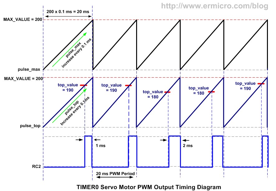

At the most basic level a PWM is a counter with a period value. So
you set the period in counts, and a clock makes it go up to period
value (if it was implemented with up counter) and then reloads and
repeats the cycle. If a down counter it counts down from the period
value to 0, then reloads and repeats. In either case the counter can
also be thought as a freq divider.
So if I set period = 10, clock in = 100 Hz, the counter cycle is
10 Hz.
Now add a register that has a value in it <= period value. And couple
that register and the PWM counter with a logical comparator. So for
example let period = 9, compare = 4, counter is up counter. Let
compare operation true if PWM counter > compare value. So PWM
counter counts from 0, hits 5, and the comparator out goes
true during 5 6 7 8 9, then counter resets to 0 and does this over,
but when it goes from 9 to 0 the compare operation is no longer
true so outputs 0. So for compare output, counter 0 - 4 its false,
counter 5 - 9 true. True/False are logic1/0 respectively.
So duty cycle of compare out is 50%. If we set compare value higher
then compare out spends less time true, so duty cycle drops. Lower
the duty cycle is higher.
This is an upcounter pwm
The compare value is labeled top value, 190, 200 is period value in above example.
As you can see for up counter implementation as compare value goes up, duty cycle
goes down. Opposite is true for down counter.
https://en.wikipedia.org/wiki/Duty_cycle
Regards, Dana.
