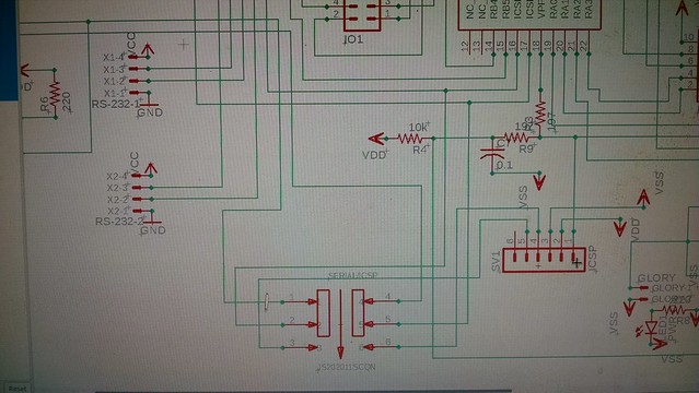

I'm trying to find a solution to the ISP peripheral components programming interference conundrum of this chip... and so far the only thing I can think of is using an analog switch on each of the chip's programming pins to reroute their connections from whatever they're connected to, to the Pickit3 programmer's I/O's. So as to avoid any conflicts during the programming process.

So now I'm upgrading my learning and diving into the world of the PIC16LF18223, which is a device with (electrically speaking) similar characteristics to the PIC10LF322, but with a bit more capacity and bells and whistles ... I chose this device because I'm need to control a bi-directional solenoid, and the PC10 does not have enough I/O's to accomplish this and the other tasks I need it to do.
Compared to the PIC10, the PIC16 has I/O's aplenty. So I plan to use a pretty straightforward circuit and have four of its pins control each of the transistors (nFets and pFets) needed for an H-Bridge.
I've already successfully used a DMN1019USN nFet at the circuit's low side to control a solenoid in a single direction, driving it directly from one of the PIC10 pins.... no problem there. But now for the high side part of the H-Bridge, I plan to use the DMP2066LSN. Which has characteristics that seem appropriate for my circuit.
Now for the details. I'm running the MCU at 3.3V, whilst the main power supply consists of four batteries delivering 6V. And I need to activate the solenoid at those 6V for it to work the way I want it to. As I've already said, I had no problem switching it with a single low side nFet by applying 3.3V at its gate. But something tells me that switching the high side pFets might not be that simple.
Question, would it stress the PIC16's pins too much if I were to directly drive the gates using a circuit like this one?:

Not so much stress the pic pins, but maybe whether you will see the P mosfets turn off fully?
No practical experience with it, just thinking out loud! ;)
Max.
I don't mean to be cheap... but I have very limited PCB space, and I'd like to avoid placing extra components if I can.
On the other hand, I forgot to mention that I plan to switch them on by pulling their gates down, but switch them off by configuring the MCU's pins as high-z inputs. That way they should completely turn off...
My question remains ... would the MCU's pins (which would be working at 3.3V) withstand a 6V pull up through a 100k resistor? ... or maybe I could use an even higher resistor... say 470k?

If you are going to have turn-off pull-ups for the P-mosfets, why not turn-off pull-downs for the N-mosfets. Same logic for each. 100K seems a bit large to me; 10 K will give faster on/off and add no more stress. I would not worry about gate resistors to limit current, but if you have ringing, you may want to use a small (10 Ω to 100Ω or so) gate resistor on each. Ringing can delay the transition and lead to heating.

There will definitely be pull down's at the nFet's gates, sorry for the omission. As for ringing and such, I don't consider that an issue, since I won't be applying PWM, and activation will be very sporadic (in the order of just one per several hours), and it would last for about 3/4 of a second.
I'm going to experiment with values between 10k and 100k as pull-ups/downs, see which is the highest I can use without affecting performance. Low current draw is critical in this application.
