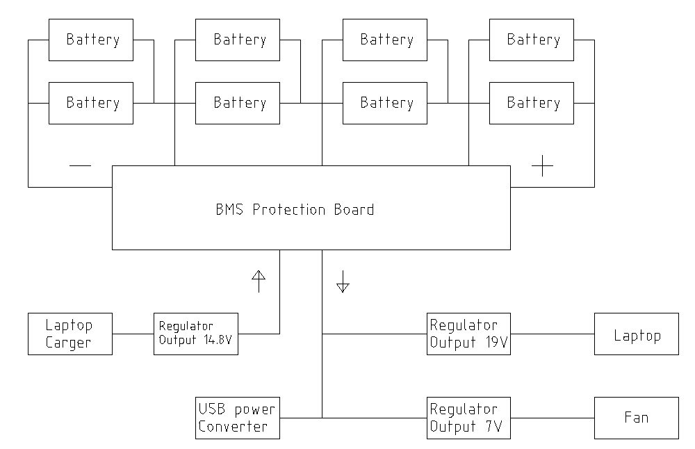

I just bought an msi gs30 laptop, which has the 2 major complaints about it being noice and batterylife. I thought I'd make a table for it in plywood, with a batterybank and a fan under the cpu. The plywood and fan I can handle, but I've never made a batterypack before, so I want to make sure I'm doing this right(don't wanna fry a 2k laptop, right?). What I've done is made some (unfinnished) designs for the laptopstand, but I know I can easaly fit 8x18650 batteries and some pcbs in there. I found some panasonic batteries, and some circuitboards on ebay, and made a schematic. I'd like any input you guys could give on this

And here's picture of my circuit:
Any input is apreciated, but the only thing I can think of off the top of my head is: Do I need to limit the amp output somehow?

I was looking at the bms, and I saw this:
Does that means I should charge the entire thing with 4.25V, or that 4.25 is the ocercharge protection?

I read that as being what the BMS accomplishes for you - it's the voltage applied to the batteries under charge. It requires no action from you.

So I don't even need a regulator there, just straight from the charger to the bms? That would remove the low amp bottleneck on the regulator I guess, but 19V might be a bit harsh for something that small ~

Well, re-reading the specs I couldn't see anything about the required input voltage, so I guess it's still a question mark. It looks like it may be meant to take the power from a laptop's power adapter, which is typically 19-20V or so (and regulated). But that's just a guess. You need more info.
