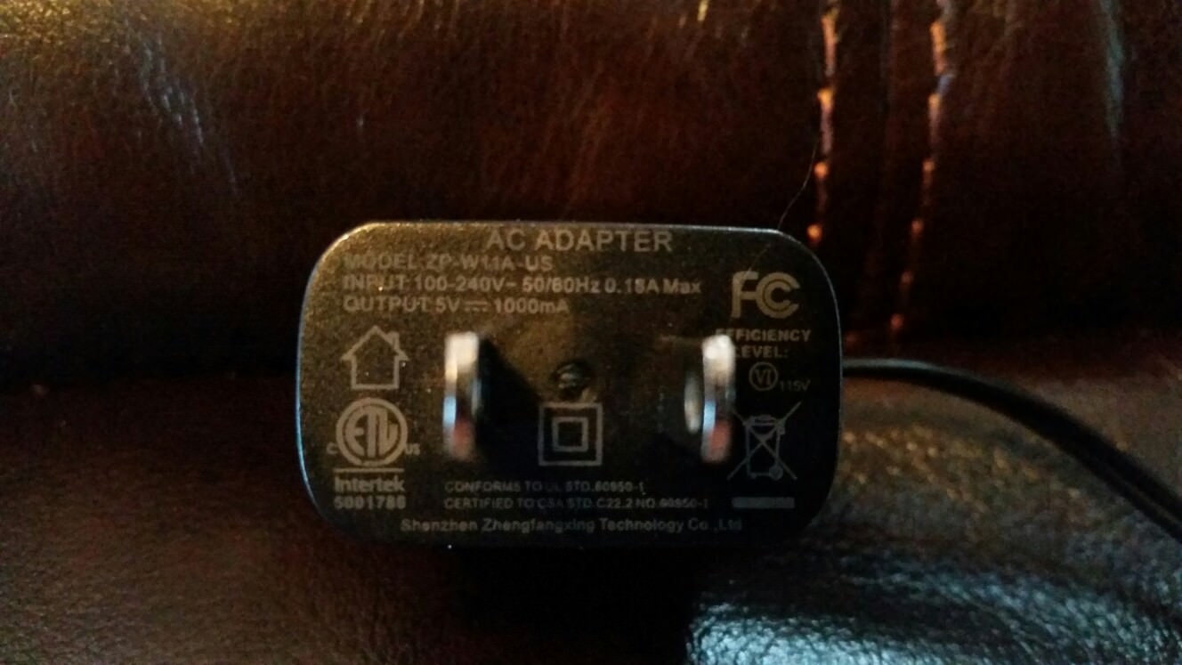

Thank you for the reply! Yes I am measuring it in the dc then AC range.
SBC: Onion Omega 2
Current: 500 ~ 2000 mA I think should be fine
Power Supply: Control: 2 AA batteries in series, One I am trying to use: Wall Wart (see image below)
Sorry about that Il try to learn what types of info people in EE ask for :)

So why are you trying to measure AC on a DC volt output?
And you are trying to power an AC wallwart with 2 AA batteries???
The Floating Brain
Joined Mar 7, 2018
17
No, the AA's are just a "control" in my test, they measure ~3.3 VDC out. But they are also registering some VAC as well. I was testing both VDC and VAC on the wall wart to be sure it wasent giving off any VAC so I wouldn't damage the SBC, especially since this one in particular say just OUTPUT: 5V @ 1000 mA, doesn't necessarily specify VDC or VAC, but since I see VDC on most wall warts I assume it means VDC, but it registers both.

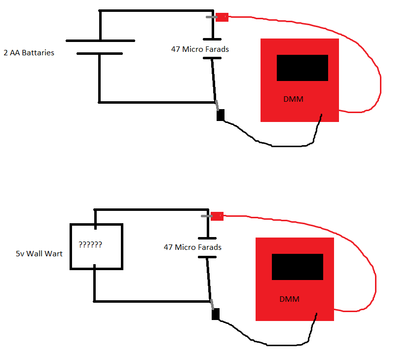

The capacitor with the lowest capacitance that I could immediately find I had was 47 Micro Farads. I hooked it up to both power sources like shown and measured the VDC and ACV across, I got the same readings as without unfortunately.
Measurement on batteries:
~3 VDC
~5.6 AVC
Measurement on Wall Wart:
~5 VDC
~10 AVC
The 5VDC device was a hypothetical, what I need to power is a few Onion Omega 2 SBC's which take 3.3VDC and 500 mA. Just found this https://docs.onion.io/omega2-docs/hardware-prep-no-dock.html In any case I just want to make sure I have no ACV going into the board before I hook it up. I know the batteries shouldent output ACV, but I want to be able to hook these up to wall power.

No, try the cap in series with the meter lead. one end of the cap to the + battery pin, the other end of the cap to the meter + lead. And the - battery to the - meter lead.
Not the cap across the battery and meter as you have shown.

Thank you!!! Readings are as expected
The DC Voltage goes down at what I am guessing is a logarithmic rate for both
AA Battaries:
VDC: 1.5
ACV: 0.0
Wall Wart:
VCD: ~5
ACV: ~5 initially then quickly down to < ~.5
To be clear (as I know you said this method is approximate), in reality, is there any ACV coming from the wall wart?
Yes, there will be ripple, that is , an AC component from the wall wart and that is normal. Better supplies have less ripple and linear regulators are best. But for a lot of uses, a 100mV or so ripple is ok. If you are using your computer board to measure analog signals, it is best to have a good supply, at least for the analog converter reference, and than either the processor inbuilt ref is used or an external very good quality linear reg is used.
Have a search for some info on switch mode and linear power supplies.
