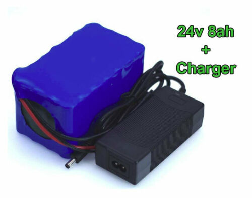

Was looking at this...24V Battery
You can use that , if you like throwing money away .... you only need a small 7s lithium ... since your scooter is 24v , the voltage match perfectly with 7s lithium ... look on ebay you'll find them with chargers ... if the battery weighs more than 1.5kg it's too big ....
You may want to keep your old lead acid on the scooter , all that weight low down stops it from tipping over .
Not sure what you mean by "7s Lithium." Can you provide an ebay link to what you suggest. Thanks
This might be a good test batt to verify that the scooter can be run on 24V Lithium.
