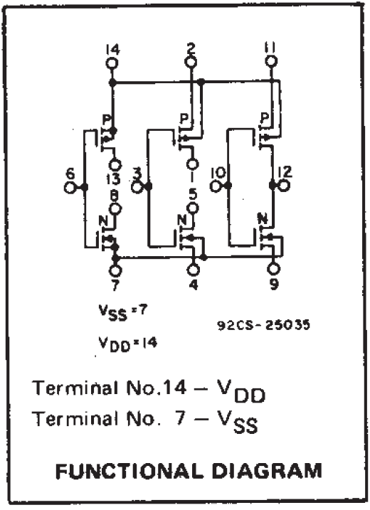

Hello, I'm having a final project for an eletronics course.
I have to implement a monostable multivibrator using an 4007 integrated circuit, using MOSFETs. I've started running into difficulties when assembling the circuit in a breadboard after running the simulations on Spice. I tried checking if results in an oscilloscope were matching the simulated ones, but they weren't.
I can't figure out if it's the pin allocation that's simply wrong or I just can't assemble stuff on a breadboard - or both. I've come here since surely there's people that aren't as dim-witted as I am.
The integrated circuit
The integrated circuit I'm using (was given) is an IC4007. For reference, here's the DIP:
Along with the prebuilt connections:
The circuit to implement
This is the monostable multivibrator using NOR/NOT gates I'm trying to do:
To make the logic gates, I've used the following MOSFET with pin-allocations:
Sorry for the crude drawing.
The functions used were:
The breadboard assembly
The result of all of this, in the oscilloscope, is a never-stopping weird shape wave that does not match the simulation. I'm starting to believe that it's an issue with the capacitor and how it's mounted on the circuit.

Pins 4, 7 and 9 aren't grounded in the breadboard pic.
vote for detecting something (not minding that incorrect - a pale pink isolation makes a good camouflage)
there are options
• mos-fet-s are sensitive to ESD and ~AC soldering iron (all leads should be tied together with fine wire removed after installation)
• the CD4000 and '4007 can have both shoulders conducting when input is near threshold ← may destroy the device
• the actual values of R --and/or-- C are different of that what they are been assumed to be (e.g. R = 1kΩ or C = 15pF)
• anything (that has) bad (electrical) connection (/continuity)

1-st connect 2 11 to 14 & 4 9 to 7 - then ::
(while testing set the other unused inputs either to Vdd or the Vcc)
• set the pull U/D resistors (about 10k) to 8/13 5/1 drive 6 and 3 ← you have 4 OUTPUT-s here
• set pullup resistor to 12 drive 10 ← you have 1 output here (pullup in parallel with the p-MOS)
• set pulldn resistor to 12 drive 10 ← you have 1 output here (pulldn in parallel with the n-MOS)
• connect 13-8-3 and 1-5-10 , set input to 6 , study chained inverting stages ← 3 outputs 3 , 10 ,12 (no pulling resistors)
• ↑ vary I/O /// connect 6 to 12 --and-- 8 to 13 (leaves the 3 as input to the chain)
• etc. -- while needed to verify the transistors are healthy

How so? With a 4007 chip?
I breadboarded the circuit using a CD4007. With a 10k pull down resistor on the trigger input and no trigger, the circuit behaved as expected (LOW output).
I triggered using a signal generator as you did and for each rising edge of the trigger, the one shot generated a pulse.
I used a 100nF ceramic cap because it was handy. The pulse width seemed a little long, but I don't know the tolerance of the cap.

But did you assemble it like the pic or with minor changes?
I used a 8.2k resistor - only one - with a 150nF capacitor using that exact layout of the breadboard and pins and was met with a fine pulse wave but CH2 on the output node gave me weird waves instead of a pulse. Chip was tested, btw
