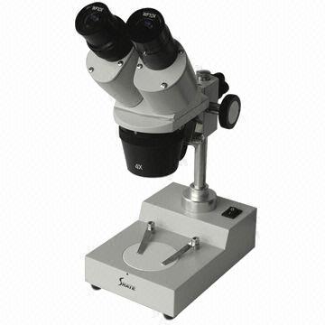

Microscope (something similar to this).
You can try a USB camera and LCD screen.
