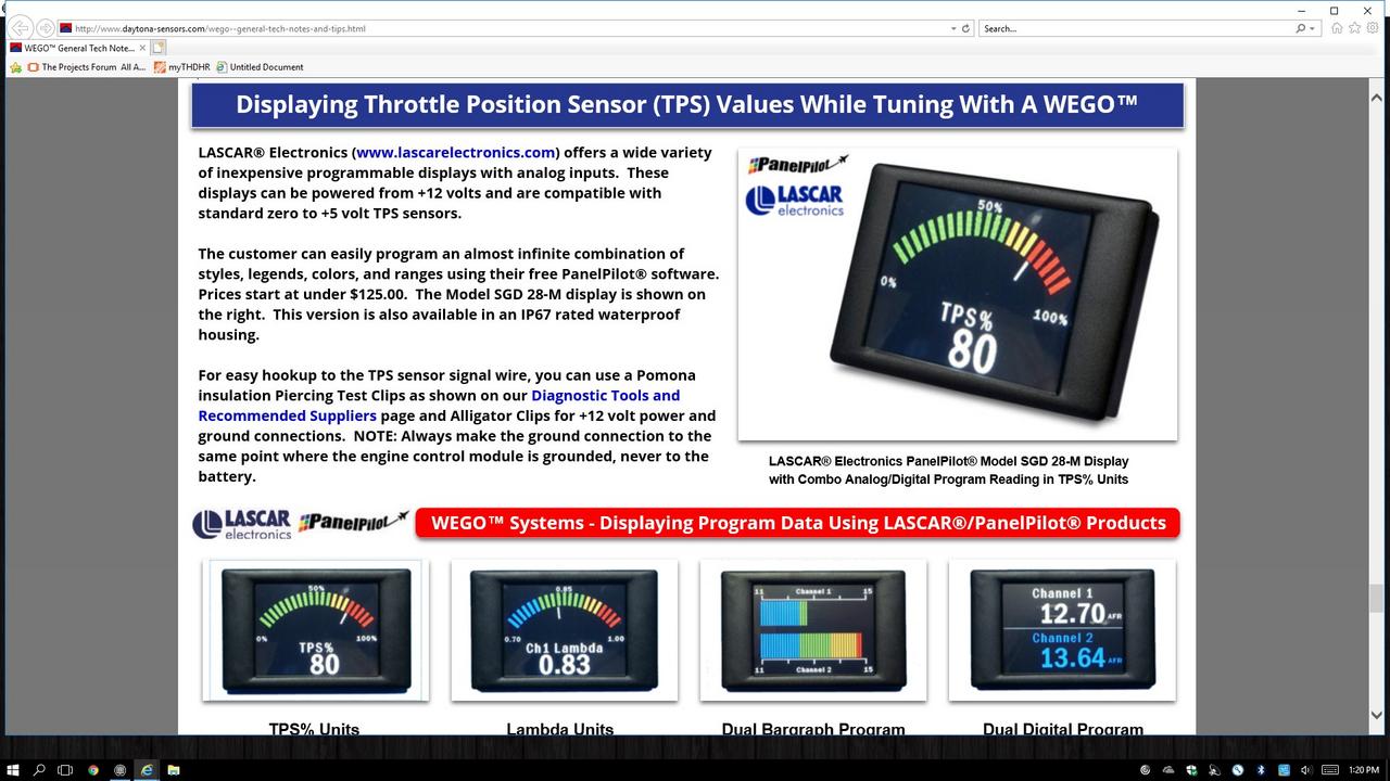

There are MAP and various dashboard monitors/meters at this site.
http://www.daytona-sensors.com/wego--general-tech-notes-and-tips.html
Is this something I might look into for a nearly off the shelf solution? I have yet to contact them but they may have something close enough to
"tweak" to my needs. That larger image below would be absolutely perfect if the needle could be simply centered at 50% indicating vacuum balance.

WEGO makes and markets good stuff in my experience with friends using their stuff. Yes, if they have what you want it would be a good, simple off the shelf turn key solution. I would contact them and provide all of the particulars of your bike to make sure what comes in the box is exactly what you want.

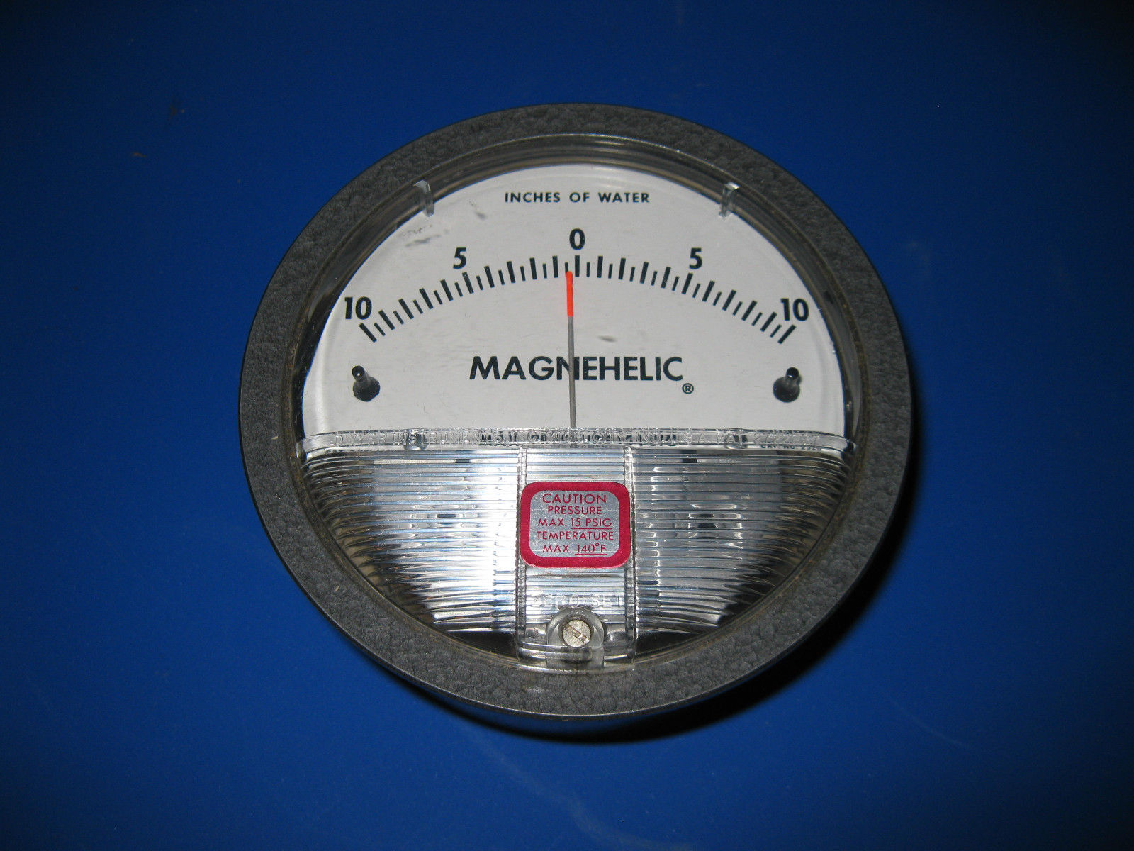

Anyone familiar with fluid mechanics?
The gauge above ranges from 0 to 10 "inches of water"
The rated pressure max is 15 psig.
According to a few sources online 15 psig is equal to 415 inches of water.
What am I misunderstanding here?
I'm told that 0-15 psig is adequate for my purposes with this project.
0-10 should be just fine since the grossed errors will simply bury the needle one way or the other.
Is there a simple mechanical/analog means of protecting the gauge from spikes in vacuum? Would an inline fixed setting 15psi 1/4npt brass bodied regulator (easy to find online), installed in reverse, do this?

Atmospheric pressure is around 15 PSI.
Since the engine "sucks" - creates a negative pressure, the max differential pressure would be 15 PSI.
That would be with one intake totally blocked, the other wide open.
But that might be pretty insensitive if you are looking for small DIFFERENTIAL pressures between carbs.
Try to find out what the actual vacuum pressure level is supposed to be, at the very least, get a unit that can withstand 15 PSI without damage.
Any type of pressure regulator in-line would horribly corrupt the readings.
in terms of spikes, just a long run of small diameter tubing coiled up would make a great spike attenuator.

27.7076 inches of water is equal to 1.0 PSI. The Magnehelic gauge above goes from -10 to 10 inches of water with a 0 center. Ten inches of water is right about 0.360912 PSI. The gauge zero is referenced to atmosphere.
Yes, and what they are telling you is the Maximum pressure that can be applied (not measured) is 15 PSIG (Pounds Per Sq. Inch Gauge) before we actually damage the gauge. At that pressure the gauge needle will be pegged but the gauge guts will be OK until we exceed that limit.
