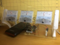

I built a circuit that read the 0.5 kWh pulse flashes from my power meter and calculated the instantaneous kW from the time between flashes, then displayed the resulting power rate on an analog meter. A PIC 12F615 timing the pulses with a PWM output to drive the meter. Some fun assembler and meter rescaling on a 270 degree movement:
